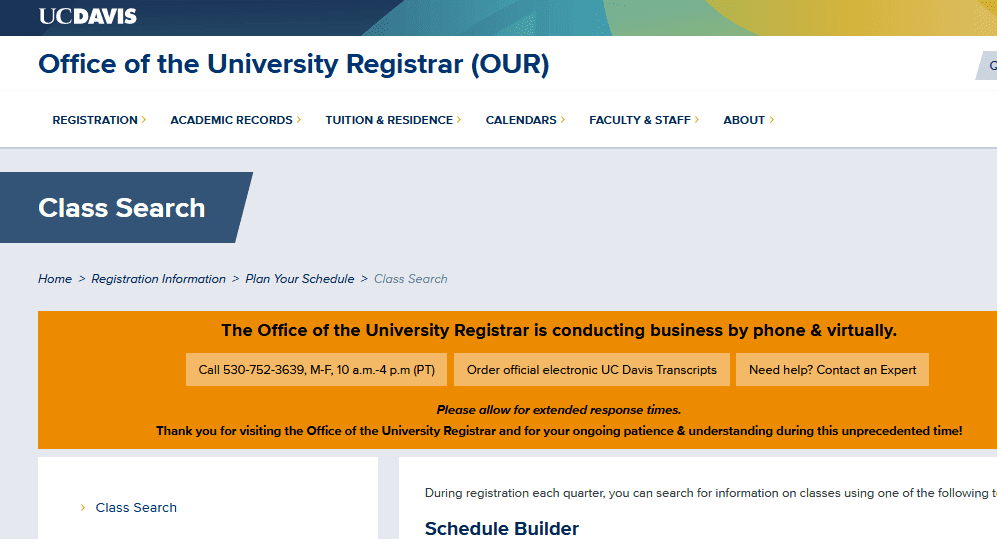

Well then maybe try searching at other universities to see what they use. I clicked into my old uni website, and found this:
https://registrar.ucdavis.edu/registration/schedule/class-search
