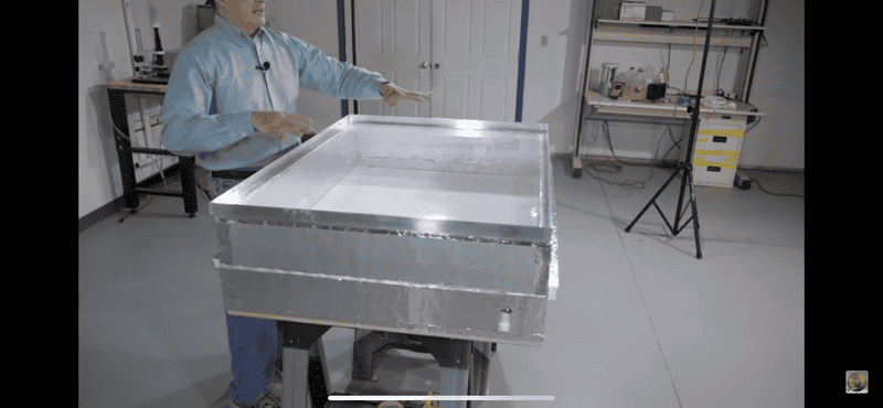

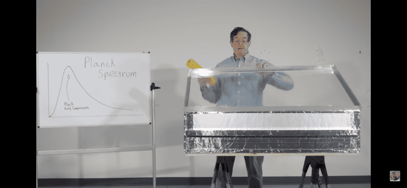

So far what I understand the layer between the radiative paint just needs to allow IR passthrough. The cold air at the bottom then transfers its heat to the heat exchanger layer underneath at that point it works as a normal radiator. So far the panels are going to have an aluminum shroud to block infrared from angles that are not directly above, as far as the material goes visible light passthrough and UV don't affect the efficiency of the paint cooling. The main concern is allowing the infrared to get out while keeping the cool air in.

just attached some pictures I'm working on how to use CAD right now I can upload some designs later on in the week!

It isn’t a Maxwell’s demon, it is just a clever use of gray body emissivity. If you can have a gray body that is nearly “black” in an atmospheric window and nearly “white” at all other wavelengths then it can exchange heat with cold space instead of with the warm atmosphere.

Have you searched low absorption and high emissivity coatings? There are materials that absorb little and radiate a lot to create exactly the effect that you are describing. Here's one list from that search: http://www.solarmirror.com/fom/fom-serve/cache/43.html. The best radiative heat transfer will be with the panel exposed without a cover. In that case, your heat transfer surface would be the rear surface of the panel.
Another search using search terms radiative cooling found a number of good hits. One of those hits has a good summary of the theory: https://onlinelibrary.wiley.com/doi/10.1002/advs.201500360. You might find the section in that paper titled Solar Reflectors and IR Transparent Convection Cover Materials interesting reading.

"Without any insulation for the nonradiative heat gain, the cooling power of the radiator is limited. In most of the experimental demonstrations, the radiators were insulated by polystyrene foam to suppress the conductive heat gain from the back surface and side walls and highly IR transparent low-density polyethylene film was used as convection cover on top of the radiator with sufficient air gap." that is the part I'm trying to over come I have to have the insulated area be covered by something that wont tear from a piece of hail or a bird landing on.
This is an interesting approach, and is not too different from the way that the temperature of most orbital spacecraft is managed. A combination of reflective surfaces and modulated radiation (louvers, etc) allow good thermal control. The absence of atmosphere is important. This is not (even slightly) a new idea; It simply isn't worth much in a terrestrial application. It works best when least needed (clear cool/dry nights) and doesn't work (at all) when most needed (solar noon). In those situations where it will work, there is usually a more capable solution (swamp cooler, etc). Reflectors / radiant barriers / shade can prevent the gain of most/all+ of the heat that could be removed in this manner. You have to climb past a lot of low-hanging fruit to get to this solution.
