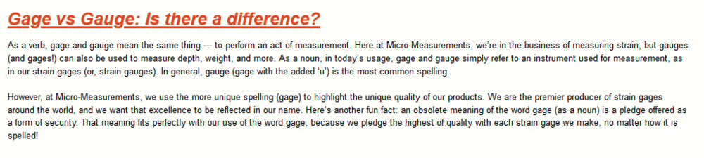

If you want to make automated measurements, look at strain gauges: https://micro-measurements.com/. Be advised that learning how to apply and use strain gauges by reading the Micro-Measurements catalog will have a loooong learning curve.
That seems to be a very informative site. . . thank you for the link. . 👍Also, did anybody notice ?
Lol, a while back, we had a small discussion about that subject. . . right here. . :wink:

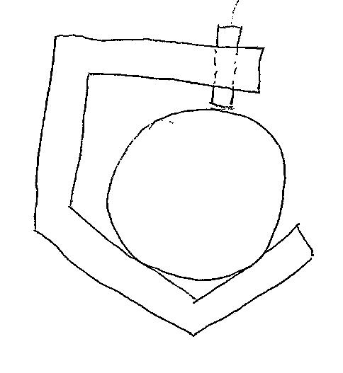

There's another way to measure changes in pipe diameter electronically. Build a fixture similar to the sketch, and use an inductive analog proximity sensor.
An inductive prox sensor sends out a voltage proportional to the distance from the end of the sensor to a metal object. Here's one that could meet your needs: https://www.omega.com/en-us/sensors...mity-sensors/iprox-series/p/E59-M12A105C02-D1.
I have used a similar sensor. In a room temperature environment, it would reliably and repeatably read to the limits of a 12 bit A/D converter. That would be about 4 mm / 4096 = 0.001 mm.
You would need to design a stiff and solidly mounted mounting bracket. You will need to consider the effects of temperature variation on the mounting bracket. If you go this way, do some experimenting by touching the mounting bracket with a finger and note just how much you move it by pushing, and by the effects of finger warming.
Big advantage is that the learning curve is much shorter than with strain gages (which I spell either way depending on my mood at the time).

This is how I would do it. You could also use a digital dial indicator or linear gage.
