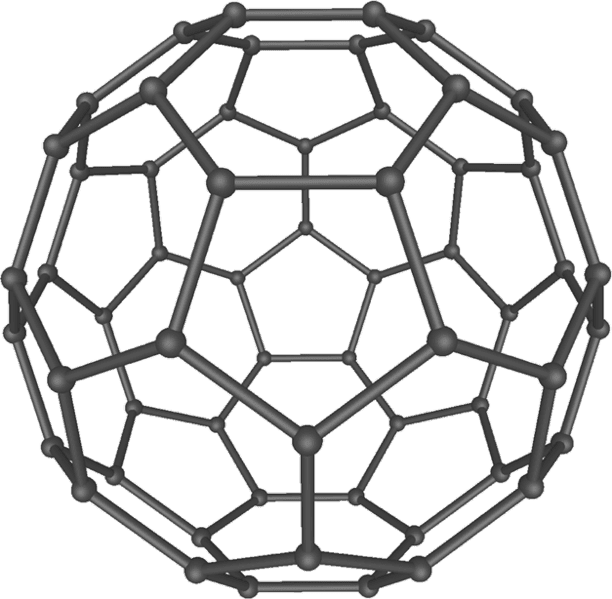

here's a way to up your cool factor, maintain access to the inside, easy (ish) to construct, and still be round.
make a bucky ball / fullerene!
I do not need to use metal, it was just the first thing that came to mind that could take some force and be solid enough to roll. I don't know terribly much about the different properties of different polymers, so I'm happy to listen. It just has to be available where I am, and be practical in the sense of the amount of tools I have.
The bucky ball looks cool, I must admit, but it may not have a good defense. I imagine there will be other robots trying to destroy me with hammers and the like, so I will have to plate the stuff in the inside. That will then make it inaccessible unless I cut the thing.. it all gets a bit complex. However, I will keep it in mind, it is pretty fancy to look at.
