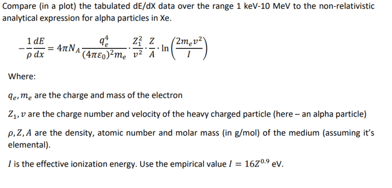

Hi all,
I got an exercise to plot Bethe-Bloch function (ignore the "Compare..." part, it belongs to an exercise above), for alpha particle in Xenon. See the question below:
I've been struggling to get a plot that makes sense. I checked my parameters and the units a million times already, but couldn't find where the problem is. On paper, the units I'm left with, after all the conversions, are MeV/cm, which is exactly what I want. But again, I get a weird curve...

I know that the peak shouldn't be that sharp, narrow, high (10^4!) and not that close to zero. Also, the dE/dx trend should be more moderate and to spread much more nicely, than this sharp drop to 0..
Would appreciate your thoughts!
Thanks.

Use a reasonable set of units! Newtons, cm, eV?
What value is the ionization potential?
There are a lot of variables in this formula. I changed all units so I can end up with MeV/cm. I suppose the problem is indeed relevant to the units, but, as I wrote, I can not find the mistake... hence this post.
The ionization potential is given in eV in the exercise so I turned it to MeV.
Would you mind going over the units and see if I messed up? I've reached to a dead-end...
