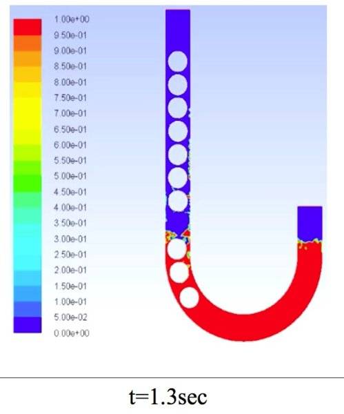

Look at a simple 2D CFD and you see turbulence, friction, and energy in a new way. 3D is even more impressive.

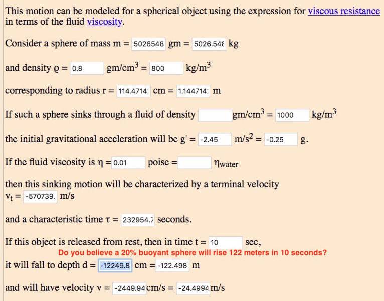

Velocity is a 6X Energy Drain. The Faster an object moves in water the more energy resistance: the energy drain is 6 times the V.

How do you engineer an optimum velocity when any increase in velocity means significantly more parasitic energy loss?

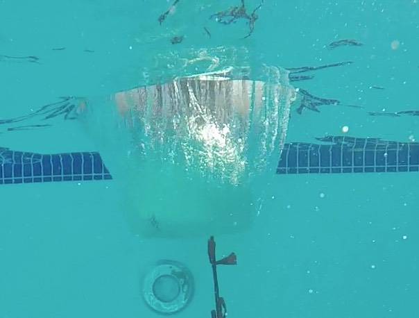

The resistance is not only when an object is falling it is ALSO WHEN IT IS FLOATING UP... negative floating...look at how fast a 20 percent buoyant sphere SHOULD be moving...with one quarter g upward acceleration ("-0.25) g.

Second, most commercial CFD programs do a poor job of modeling things like viscous drag. This comes especially from their difficulty in modeling turbulence and the transition from laminar to turbulent flow. The computational requirements to do this accurately are enormous.
Third, the 6 times velocity relationship appears to be related to buoyancy and not a general rule. The factor of 6 arises in a very specific situation called Stokes flow, where the Reynolds number is very small and the flow is dominated by viscosity. In that case, drag is directly proportional to velocity (the factor of 6 is actually fairly unimportant). In most flows, the relationship is actually that drag is proportional to the square of velocity.
In fluid mechanics, energy dissipation is generally accomplished by the effects of viscosity and the rate at which it occurs varies depending on the situation. It has been fairly well-studied if you know where to search. You should look into "viscous dissipation."

My limited experience with CFD has been shocking! I hired someone to do a "simple" model. The engineer explained that he needed to use 800 computers to "run" the model (!) and then he told me the model crashed the computers! He fixed it by changing making the time variable slower by a factor of 20 before he could even run the simulation/model.
When I saw the video I could see fluid movement that makes perfect sense and is so complicated.

Viscous dissipation happens at any velocity. The degree to which it occurs depends on largely Reynolds number. Again, it is THE largest source of.energy dissipation in a typical fluid flow and is fairly well-studied.
Also note that 20 m/s is not some magical number where things change. It honestly seems quite fast for Stokes flow to be relevant, but it's Reynolds number that determines that, not velocity.

The photograph of an open pool of water could indicate measurement difficulties and data problems. Temperature differences due to motion subsumed by evaporation and other effects. Pressure variation measures inconclusive in unrestricted fluid.
