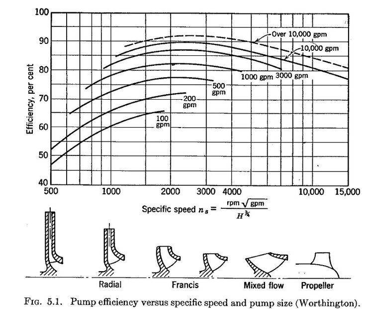

Been reading Rocket Propulsion Elements 9th Edition and got approval from my university to design a bi-propellant liquid fuel rocket engine for my senior design project, and I've been understanding everything so far but I haven't quite found an answer to how the pressure works throughout the plumbing before the thrust chamber.
The turbopump raises the pressure from 2-4 bar inlet (from the fuel/oxidizer tank) but what are the constraints on the exit pressure? I know the turbopump needs designed to prevent cavitation and have sufficient pump head, but is there a specific requirement typically for the outlet pressure, or is it solely dependent on the pump head? Also, I am a bit confused on pump head for these in rockets. The turbopump is below the fuel/oxidizer tanks, why would the head matter when it naturally will want to suck out the propellant? Wouldn't the outlet pressure be a more useful measure for the pump?

The pump exit pressure has one constraint - it must be high enough to deliver the liquid. The liquid is delivered into the combustion chamber, which is at a pressure. There will be a pressure drop at the nozzle, and pressure drop in every line and fitting between the pump and the nozzle. You start at the combustion chamber, follow the fuel path back to the pump, and add up every pressure drop on that path. That gives you the pressure at the pump discharge.
Similarly, the fuel and oxidizer tanks each have a pressure. The lines, fittings, and valves in the flow path from the tanks to the pump inlets all have pressure drops. The tank pressures minus the pressure drops give you the pressure at the pump inlets.
You also need to calculate the net positive suction head (NPSH) at the pump inlets.
Then you are ready to start designing the pump. A good general reference on pumps is Centrifugal and Axial Flow Pumps, 2nd Edition, by Stepanoff: https://www.amazon.com/dp/0894647237/?tag=pfamazon01-20. There are other pump books that may be better, this is the one that I have. This figure, from that book (page 76), shows how the relationship between flow rate, RPM, and pump head affects the design of the pump.
Also, be sure to calculate the power required to drive the pump.
A fun project, but you will need to carefully constrain your efforts in order to finish in time. Enjoy!
