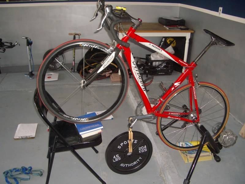

What I'm saying is that if you wish to test the torque readings of a crank spider based power meter by comparing it to the known torque applied when hanging an accurately known mass from the pedal spindle of a horizontal crank arm of precisely know length while it's in the forward position (either crank arm, it doesn't matter), then naturally you need to secure the crank spider to prevent it from rotating, else the torque applied will simply see the mass fall to the floor.
You can easily do that via securing the rear wheel so that it cannot rotate, and then the chain which is attached to the rear cogs and the chainring and via that, the crank spider will prevent the spider from rotating, which is all that you need do.

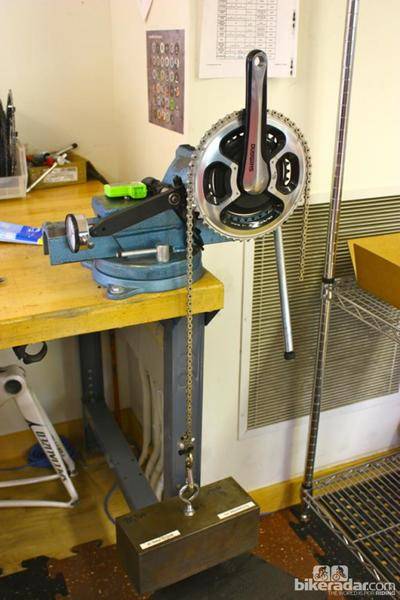

Here's an example of how you might do that. This is not my picture, I think it's from John Verhuel. I do a similar thing, except that I have special "pedals" I screw into the crank arm which enable me to slide weight plates on/off easily without need to raise the bike up to give room for the weights. If you are testing a crank spider based meter (not the hub based meter in the picture), then the size of the chainring is not relevant, it's only role is being means (along with the chain and cogs and rear wheel brake) to prevent the crank from rotating while under the load being applied.
However if you remove the power meter from the bike and clamp it in a vice and hang a mass from a chain wrapped around the chainring, then knowing the precise radius of the chainring at the vertical tangent point the mass is hanging from is needed in order to calculated the applied torque value accurately. This radius gets harder to precisely measure with a non-circular chainring. With a circular ring it can be calculated fairly easily as tooth size determines chainring radius. In this method the crank arm is removed from the process and the spider is secured from rotating via the BB spindle being held in a vice.
I prefer the method of doing it while the unit is installed on the bike, one because it's more convenient, secondly because it's a measurement in situ, thirdly because you can test the torque values while applying the torque to either drive and non drive side crank arms, and finally because it removes the need to know the chainring radius, all you need to know is the crank arm length (which is easy), hence you can test with whatever chainring you like, circular or non-circular.

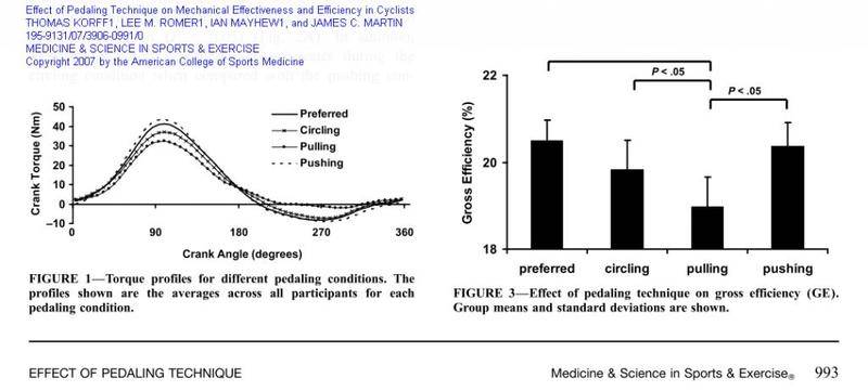

Toe clips, pedal cleats etc may enable some amount of pull up, but the reality is that evening out of torque around the pedal stroke does not happen, and will never happen. Hip and knee extensors are far more powerful than than hip and knee flexors.
Pedal force studies using riders with pedal cleats clearly demonstrate this - e.g. look up data from Korff et al where they measured such pedal forces from riders instructed to pedal in a different manner, including "pull up" and "circular" pedalling. Here's an image comparing average pedal torque profiles with 4 different pedalling techniques for eight males cyclists:
Baluncore said:
Toe clips and cleats make a big difference, far more than an asymmetric chain wheel possibly can.
And yet in performance tests, riders are able to maintain as much aerobically sustainable power using flat bed pedals as they can with cleated pedals. Indeed incremental tests to exhaustion show no difference between such pedal set ups.
Here's an example of a performance test comparing flat bed pedals and cleated pedals:

Ah, OK. Well it was just an example of a trained cyclist* performing the same 6-min test on a cycling treadmill (meaning the power demand was controlled and the same for both tests) using both his regular cleated pedals and with flat bed pedals.
They measured the rider's blood lactate response, heart rate and oxygen consumption. There was no significant difference in the physiological measures between the tests, although the rider did demonstrate better gross efficiency during the flat bed pedal test.
* a cyclist who claimed to have a "circular pedalling technique".
