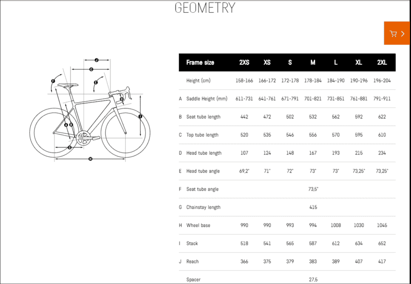

Actuator: In such a design the most challenging part is the beginning because it's very hard to find where to start. So my first request will be an advise about that. I thought the dimensions may help:
I'm a tall guy, 187 cm ( 6 ft 2 in US system). So I can benefit from this table. That's ok.

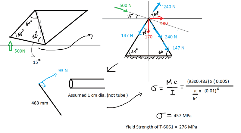

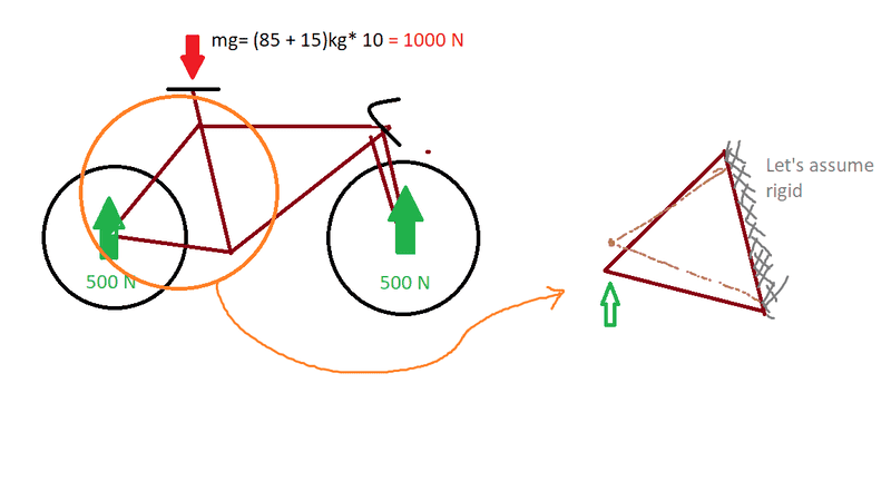

My attempt: (Note: Of course this is very inaccurate, no bar and no shafts are rigid, the whole frame will deform together but I'm trying to get rough values about the stresses) (Correct me when I'm wrong)
I weight around 85 kg and added addiotional 15 kg for simplicity. So the wheel axles react in 500 N, I assumed the seat bar as rigid then the triangular part is subjected to bending.
But when I do some calculations I get weird bending which are very high compared to yield strength of T-6061 Aluminum due to assumptions.
I think my assumptions deviate somewhere if the calculations are correct. I need you help here and I leave it here for now. It's 5:12 am here :)
![Y6PnRZ.png](https://i.hizliresim.com/Y6PnRZ.png)
![6NRgLl.png](https://i.hizliresim.com/6NRgLl.png)
![j6JEPG.png](https://i.hizliresim.com/j6JEPG.png)
