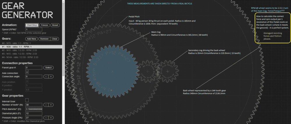

What is the output of Torque on the driver wheel of a bicycle(where it meets tar), verse the input of torque on the pedal. I have all the sizes and forces, yet the correct formula eludes me.
A person weighing 60 kg exerts 30 kg of thrust on a pedal (crank) x 2 pedals = 60 kg of force per Revolution. Let's say @ 30 RPM.
What is the output kg of force per RPM on the back wheel where it meets the tar.
The ratio per 1 RPM of the pedal crank to wheel is 2.571
The Pedal ( Crank ) size is Radius 165mm and circumference of 1036.7mm or ( 70 teeth simplified )
The Main Driver cog is Radius 90mm and circumference of 565.5mm or ( 38 teeth )
The Secondary cog ( driving the back wheel ) is Radius 35mm and circumference of 219.9mm ( 18 teeth )
The back wheel is Radius 340mm and circumference of 2136.3mm ( 144 teeth )
Please see image to clarify
I am not interested in resisting forces or frictional forces - rather let's say these do not exist for this exercise, call it a perfect system.( I am still learning )

Without cleats, a 60 kg person will put all their weight = 60 kg force on the pedal.
The crank radius is 165 mm. Large gear is Radius 90 mm.
Chain tension is 60 kg * 165 / 90 = 110 kgf.
Small gear is radius 35 mm. Wheel radius is 340 mm.
Force from tyre along the road = 110 kg * 35 / 340 = 11.323 kgf.

Awesome, thank you so much.
