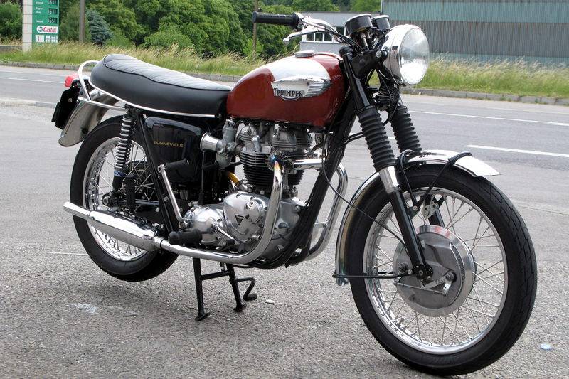

Sooo... you had a 650 Bonneville, huh? ... well now I'm mad, 'cause I never did...[COLOR=#black].[/COLOR]:oldmad:
1oldman2 said:
...650 Bonneville...
Lol, I sure as hell wanted one though... dreamed about them, all the time...[COLOR=#black].[/COLOR] :oldwink:

Ha!... but I do have a 1986 1,100 cc Harley Sportster, with the Evolution engine ... the first year Harley made them...[COLOR=#black]..[/COLOR]:approve:

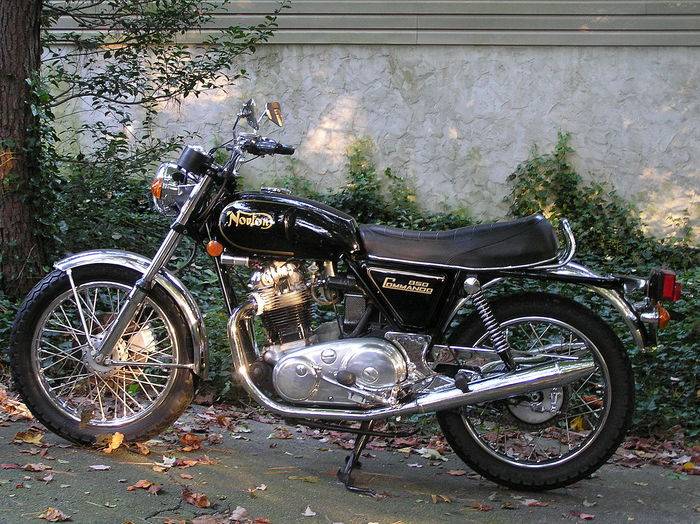

Sweet! The Limey bikes are a family tradition here, although I did have a "sporty" at one time, The 850 commando is a kick in the ass also. :woot:

British motorcycle - Norton 850
I owned a Norton 850 command for a few years. The engine, transmission, and swing arm pivot were attached to a sub-frame (two pairs of plates, one pair in front of engine and one pair in back of engine, plus a mount at the top) rubber mounted to the main frame to reduce vibration. Exhaust pipes were also rubber mounted. The shift was on the right, and also "backwards": 1 up (shift from first from neutral) and 3 down (for "upshift"), the opposite of most other bikes.

i notice those photos have shifter on correct side. Rule Brittania !

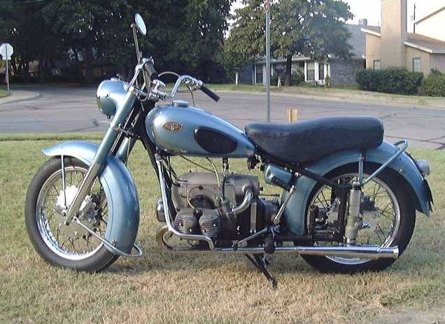

My very first Motorcycle was a Zundapp 600cc, well used when I bought it in the early to mid '60s. It wouldn't do a wheelie due to the design. Pop the clutch and the backend would boot you in yours. Being young and foolish I wanted to see what it would do; an unbelievable 43 feet of rubber on blacktop! Yet very smooth for cruising.
Here is a stock photo that is the closest I could find, it looks a bit more recent than the one I had. (Loved that 'ride-off' center stand.)
Unfortunately it died of 'hardening of the arteries.' A clogged oil line to the front main bearing sheared the crankshaft.
