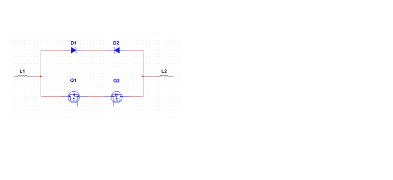

Back to back mosfet aka a two series mosfet bidirectional switch?
This solves the current conduction in reverse direction problem but now I have to drive two mosfet instead of one for every switch I need and I need a gate drive IC etc,

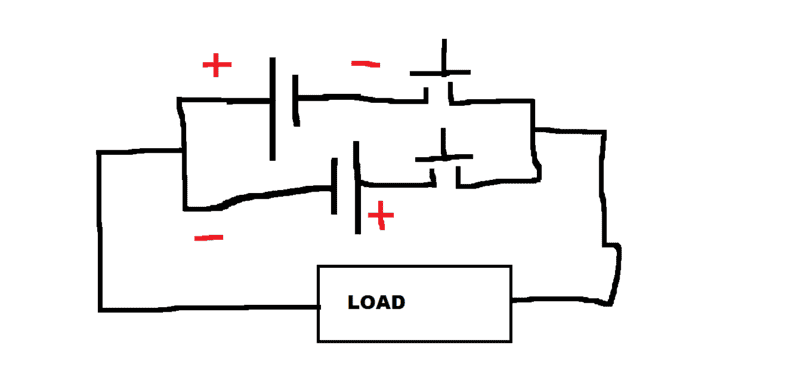

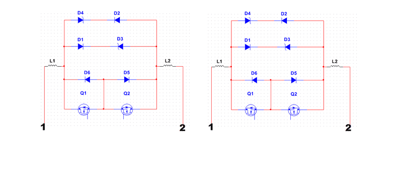

Let me make this easier by making a drawing.
My voltages are low, from couple of volts to double digits not more.
Assume I have two batteries with opposing polarities, I want to switch them through a load to create an AC current through it, say I have just two of them so two switches, the problem as already described.
Current could get high, so low loss/resistance would be beneficial in terms of switches.
My wish is so that I could create a simple driving circuit as I wish to use semiconductors for the switches because they are fast , relays are not an option.
So a fast switch , not necessarily high voltage , but one that can block reverse current when met with reverse polarity, so a single mosfet doesn't work.
I wonder what are the easiest most common alternatives?
Are you sure you would not be better off with a simple H-bridge instead?
What you have there is half an H-bridge.

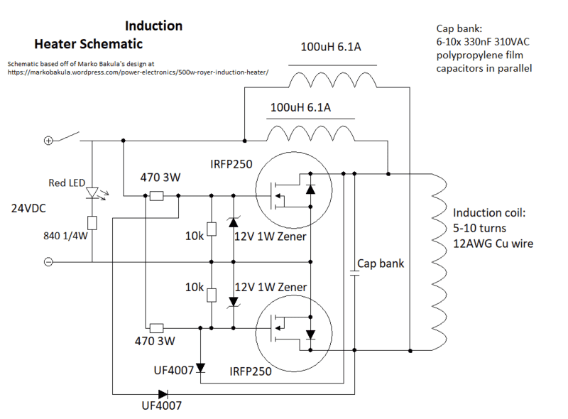

I thought my comments were directed at everyone, including your simplified half-bridge models.
missing: a reference to my schematic. [my bad]
https://christianmalherbe.com/Induction Heater.html

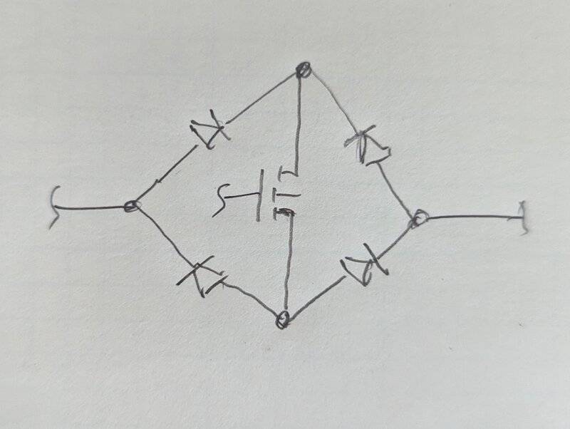

Putting the switch inside a bridge is simple, in some ways. Extra diode voltage drops and difficult FET drive are issues though.

@DaveE I think that this configuration doesn't differ from a two switch series bidirectional switch, because either way one gets two diodes in place of the other transistor which together is either equal or higher of a series resistance isn't it?

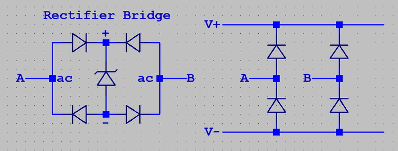

@DaveE 's suggestion will rectify bipolar source current from a unipolar switch since it interfaces with a full wave rectifier. Is that all you need? That is just a simple concept.
Yes. I think you're right if you only have one transistor. Most topologies will use two transistors (usually in series) for this reason.
But no (if I understand your comment), transistors, properly selected, will have a lower voltage drop than diodes. Synchronous rectifiers are a good example of this. If you need low voltage drop, you may want to replace your diodes with FETs. Of course, the MOSFET Rds(on) becomes an issue at very high currents. But then you can switch to BJTs, SCRs and such.

I would probably just put two N-Mosfets in series. Either with the drains connected or the sources connected together, depending on your gate drive circuit choices. You can either use the body diodes or you can turn them both on together to get lower voltage drop.
Much of this design will depend on how you want to design the gate drive circuits. It's probably best to have the G-S nodes in a part of the circuit that doesn't generate a big dV/dt across the isolation barrier during switching, I think. Although that isn't necessarily possible or even optimal, depending on the application. There are lots of options here.
Note that many comments related to half bridges aren't really bidirectional switches, topology wise; which is fine if that works for you too.
Your array of wires is like a Y or star-connected motor which can be as many phases as your want, typically 3 or more. Thus is defined as a "half-bridge" for each phase or wire with dead-time commutation.
If your power is low, it is pretty uncomplicated to simulate if you have interface specs.

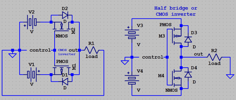

OK, changed my mind. Since you have lots of coils each being switched to a common node, I guess I would opt for the easy gate drive option. This would be an N-FET and a P-FET in parallel each with a series blocking diode to prevent reverse current. Then all of the sources can be at a common node which will make the control circuit much simpler.
I don't think those diodes will prevent shoot-through @DaveE .

Sorry, I guess I should have drawn a schematic for you. When it's on everything "shoots through". When it's off, nothing "shoots through". It's a bidirectional switch, that's what it's supposed to do. Where does the current "shoot" to when you turn the switch on? IDK, that's not our problem, yet.

I as @DaveE correctly said ,I actually need the "shoot through" to happen.
The idea is basically this, I have many parallel wires, each wire has a switch in it, the wires carry bidirectional current. That's it. If it makes it simpler for you @TonyStewart imagine many mains phase wires all in parallel and all of the same phase, current goes forth current goes back, put a switch across such wire and you need the capability to block current in both directions which with a single mosfet isn't possible due to the body diode. That is it, this is all the problem.So what I was originally looking at, and still am is this

The simple two FET back to back series configuration is known to me, I have implemented that already in a solid state relay in an amplifier output.
The reason I was asking is because that kind of configuration needs a more complicated gate drive circuit, no problem for a once on , once off amplifier output relay, but becomes trickier for many parallel switches that also need fast switching.Maybe I can sacrifice a little bit of that RdsON switch resistance by omitting a switch and putting instead a fast recovery diode in it's place or something like that.
Likes DaveE
I thought about this, but I think there are two problems, possibly, first is that there actually isn't a common node on either part of the switches, because there are additional devices "down the line" so whenever current reverses there would a PD of some couple of tens of volts that also reveres across any closed switch.
Secondly , isn't it the case that all P fet's have higher RdsON than their N channel counterparts due to the inherent structure of the device itself?
Doesn't this affect voltage drop for low voltages ?

I doubt you'll get all of that. It'll be a trade off.
Schottky diode then? Lower Vf and I think you said it's a low voltage application.
low voltage yes, but high current, will have to look into it, don't know from the top of my head but IIRC schotky's were usually in low power applications?

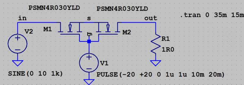

Since this is high-current low-voltage, if you connect two N-channel MOSFETs source to source, and gate to gate, do you not have a bidirectional switch between the drains, controlled by ±15 volts on the common gate terminal?

  • #32
artis said:
In theory yes, by the way isn't it the case that in common source mode for two series N fets the voltage drop for either current direction forms only across one of the two switches given the other is bypassed through the body diode therefore before applying voltage to gate to turn ON the PD is across one switch in either current direction?
When both MOSFETs are turned on, neither body diode conducts.
When both MOSFETs are turned off, one body diode conducts, the other blocks current.
The source floats when off, but quickly resolves the situation if it is negative, since a MOSFET then turns on sufficiently, to turn both off. The source cannot float high, because then a body diode will conduct.

  • #34
But I can also ground the source with respect to the gates at all times within the gate drive circuit, can I not?
It shouldn't affect the voltage/current of the main path through the FET's nor the gate drive circuit itself because the two circuits - the power and gate drive one don't interact.
