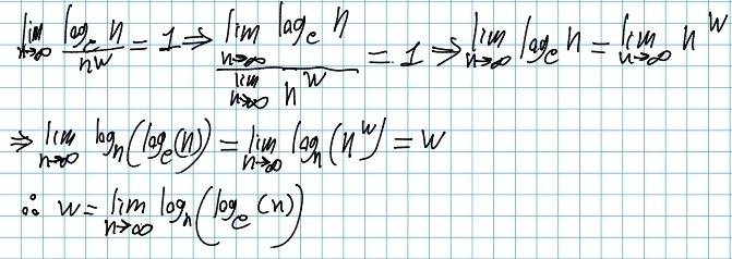

Is what I just did (in the attachment) nonsense? If not, what do I do next? If it is, then what's the first mistake I made and how can I correct it?
You did the limit incorrectly; here's a (counter) proof of a similar claim to help you get started:

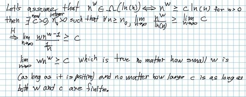

How about this proof (that I just attached)? Is it good?
Edit: I forgot to mention w is a real so imagine that I stated it in the proof.

That's the gist of it. If you really wanted to be rigorous, l'hopital's rule can't be applied to functions of integers (it's a calculus result) so define functions [tex]f,g:\mathbb{R}\to\mathbb{R}\quad\text{as}\quad f(x)=x^w,g(x)=\ln(x)[/tex] and then apply l'hopital's rule. Since the integers are a subset of the reals, the result will hold true if true in the continuous analog. You also don't want to assume the theorem you're proving in the beginning since it will end up as circular logic.
Thanks for adding since I care about rigour. I got the integer/real statement you made but, as for the circular logic part, I don't see how what I did is circular reasoning because I started with an inequality that did not isolate the constant and I then: 1) took the limit of both sides 2) isolated for the constant 3) applied l'Hopital's rule. So, what, specifically, is circular?
The circular reasoning lies in the fact that you assumed your proposition is true before proceeding to prove it is true.

Oh, wait! I think it's just that the wording was confusing. When I said "Let's assume "[. . .]" I was saying to assume that the big omega statement is equivalent to the inequality and not saying to assume that the big omega statement is true.
Having said that, is my statement fully correct?
