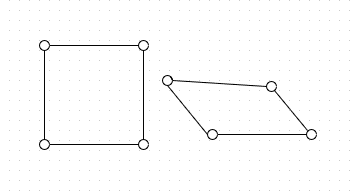

It looks like this
Where the ith entry of the quad and square coordinates above are corresponding corners.

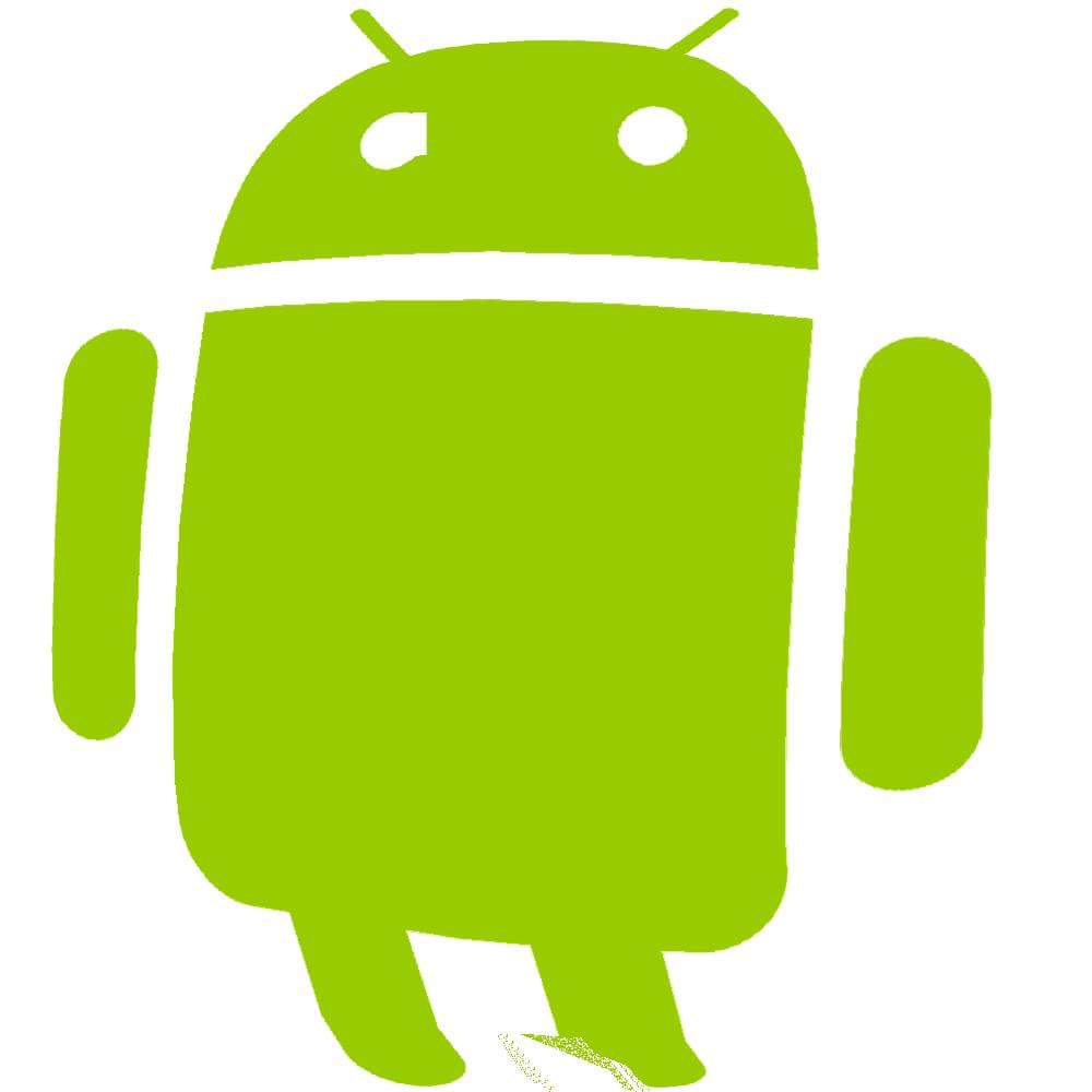

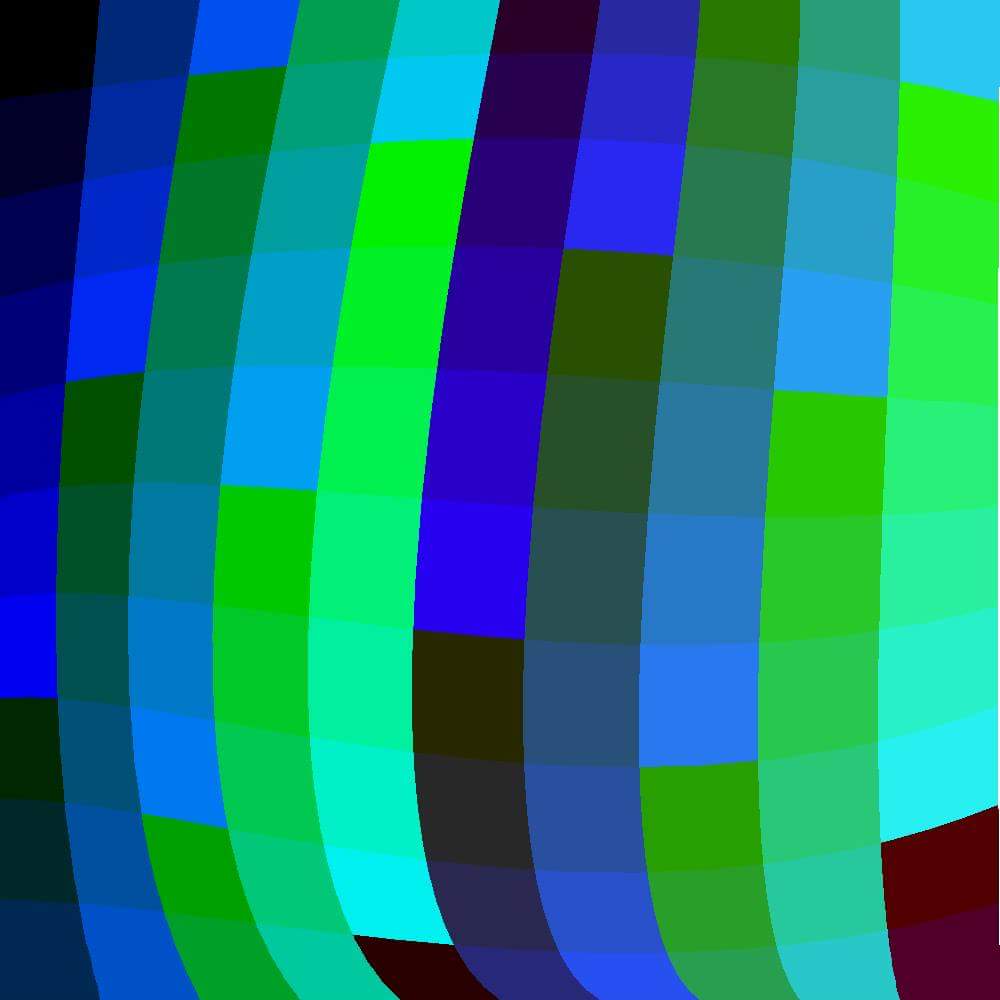

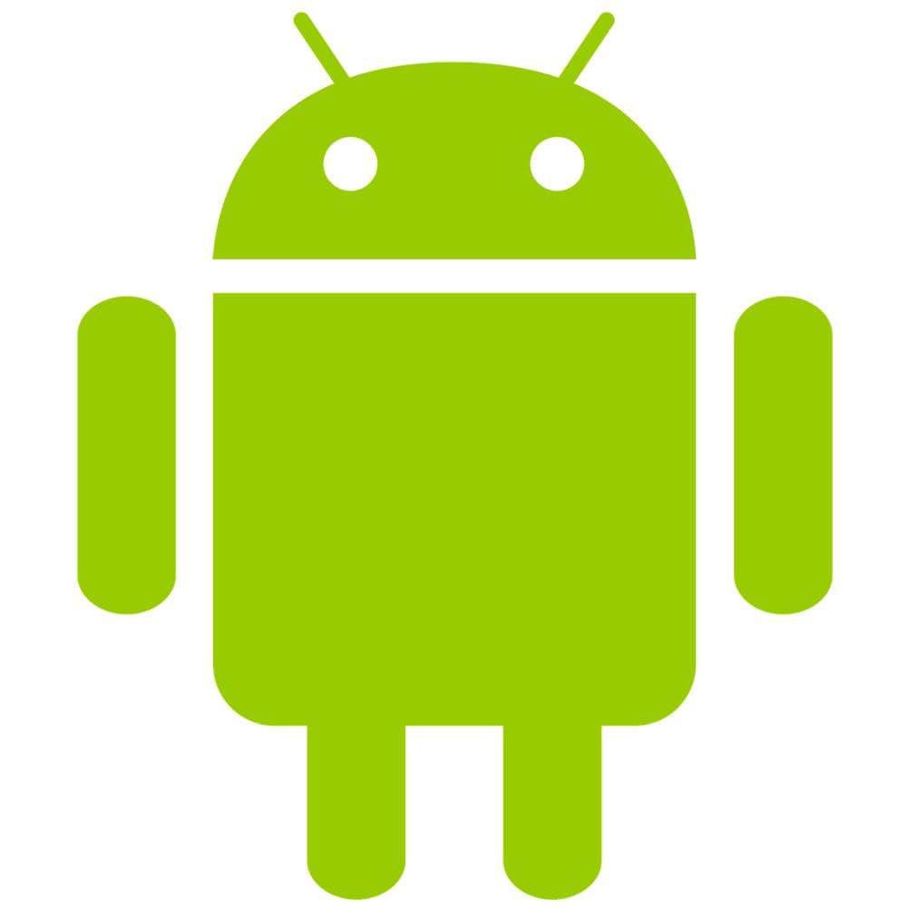

I did a test and tried to warp an image and this seems to work in general, but then in two places the formula messed up. See these two pics.
The left eye got messed and the right leg got messed too. The above example quad is for the right leg.
original:
warped:
using this warp template:
