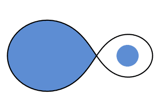

Probably thinking about the Roche lobe. Wiki has an article on this. Key point being that there's the revolution of the system to take into account when drawing the equipotential (Earth-Moon tidal deformations can neglect revolution).

Well, this is what Wiki has under Roche Lobe:

A binary will look like that when one star is large enough to fill its Roche lobe, and starts transferring mass to the other star.
"Mass transfer due to Roche-lobe overflow is responsible for a number of astronomical phenomena, including Algol systems, recurring novae (binary stars consisting of a red giant and a white dwarf that are sufficiently close that material from the red giant dribbles down onto the white dwarf), X-ray binaries and millisecond pulsars."
https://en.wikipedia.org/wiki/Roche_lobe
