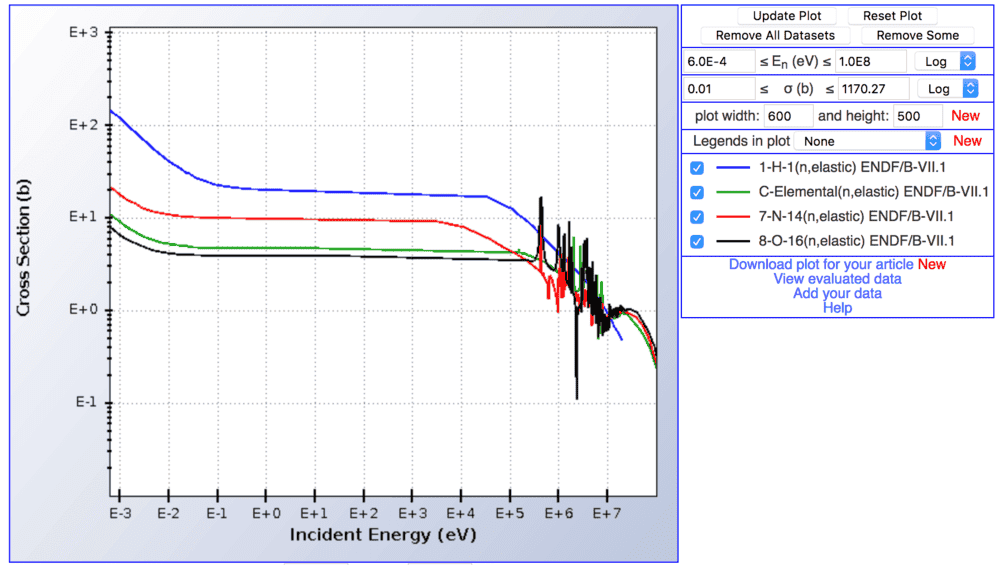

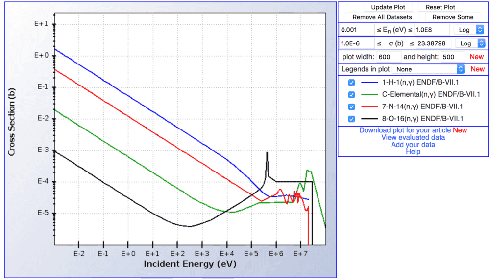

I plotted the cross-sections for radiative capture (n,γ) and elastic scattering (n,el). They show a greater probability of scattering over the energy range 0.001 eV to 100 MeV. For the radiative capture, the probability is greater for H until about 200 keV where the capture cross section of O becomes greater. I do not know the neutron energy spectrum of solar neutrons, but the following might provide an answer: https://agupubs.onlinelibrary.wiley.com/doi/full/10.1029/2010JA015930
Based on the cross-sections, it would appear that a neutron is more likely to scatter than be captured such that it would eventually decay (t1/2 = 613.9 s) to a proton, electron and antineutrino.

  • #31
Thanks for the information.
