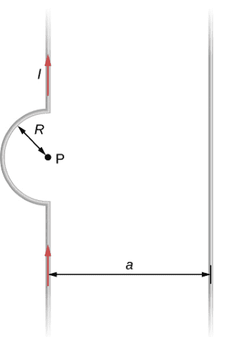

Two long wires, one of which has a semicircular bend of radius R, are positioned as shown in the accompanying figure. If both wires carry a current I, how far apart must their parallel sections be so that the net magnetic field at P is zero? Does the current in the straight wire flow up or down?

Okay, since wires have a 'parallel' parts, they cancel out, leaving only the semicircle and second wire needed to be calculated. Current on 1st wire heads upward, so Right Hand Rule indicates the field going inward at P from the semicircle. To cancel out, the field on the straight wire has to go outward - right hand rule says I should be upward as well. (Correct?)
B for semicircle:
B = (μo/4π) ∫ I*R*dθ/R2
B = (I*μo/4π)/R ∫dθ
∫dθ = π
so: B = (I*μo/4π)/R
Now I have to find -B with respect of the second current I with r = a, and add them together to get the answer.
B = (μo/4π) ∫ I*a*dθ/a2
B = (I*μo/4π)/R ∫dθ
∫dθ = 0
Meaning B = 0, which I know is not correct. Help?
Seems OK to me
What is the B field from an infinite straight current carrying wire ?
Likes Ignitia
Ignitia said:
B = (I*μo/4π)/R ∫dθ
∫dθ = π
so: B = (I*μo/4π)/R
The π in the denominator of the last equation cancels with the π from the integral.
Likes Ignitia and BvU
Woops, missed that. Thanks.
BvU said:
Seems OK to me
okay, got it. Infinite wire simplifies to B = μ0 * I / 2πa
So B1 - B2
μ0 * I / 4R - μ0 * I / 2πa = 0
μ0 * I / 4R = μ0 * I / 2πa
4R = 2πa
2R/π = a
Thanks!
