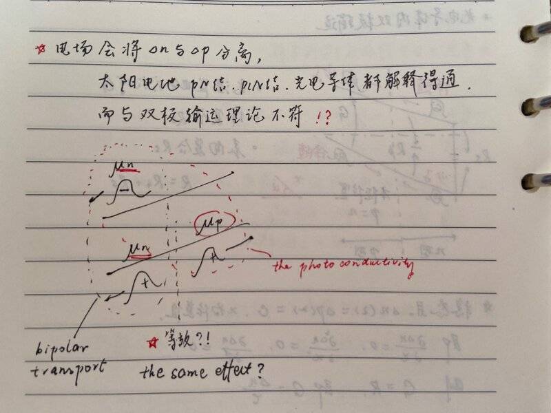

I feel quite confused for a few days, when I apply the bipolar transport equation into a voltage-applied semicondutor material (e.g. p-type c-Si bar, or a resistor) which just have some light-generated electron-hole pairs by a pulse of photon at somewhere on the bar. In terms of bipolar transport theory, the delta n and delta p should go together along the bar in the direction as the so-called minority carrier should go (as the e.g. above, the electron for a p-type c-Si) . However, it seems that there will be no net light current, because delta n and delta p always accompany each other on the 1-D bar. On the other hand, we always use the delta n + delta p the sum to give a light electrical current (i.e. light conductivity).
Please give me some hints, there must be somewhere wrong.

But the material must be externally biased in order to produce current. Why do you think they are equal??
When there is a current in a material externally biased, could you help me to analyze the composition of the current, the density of two carriers and their movement direct? I thought about it for a while last night and attach a file below, that could explain my confusion easily.
I believe the the conductivity comes mostly from the majority carriers whose number in the conduction band is promoted by the light, hence the photoresponse. I do not understand your sketch but I believe the "bipolar transport" is secondary.

Thanks guys. I could withdraw this "problem" for now. Finally, I found my mistake, the bipolar transport, ie. the movement of the delta n is totally different the electrical current. the bipolar is more like a kind of forms, but when you look into the current, you have to go to the movement of the n and p. Anyway, thanks your guys so much.
