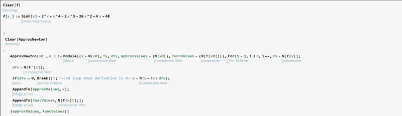

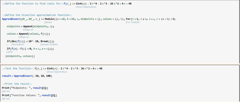

Hello! I need to write 2 functions in mathematica, to find the roots of functions. The functions are the Bisection methods and Newtons Approximation.
(b1) Write your own function ApproxBisect[a0_,b0_,n_], which starting from an initial interval [a0, b0] approximates a root of the function in n steps. As a result, output the list of the n interval midpoints and the corresponding function values.
(b2) Test your function for the function f over a suitably chosen range and an appropriate number of approximation steps.
The function f(x) is this ## f(x) = \sinh(x) - 2^x + x^4 - 2x^3 - 26x^2 + 4x + 48 ##
Now this is my attempt at the solution (since I dont know how to post mathematica code formatted nicely I will put a screenshot)
For Newton I tried this
And I printed all the values as a list (I can post a screenshot of the code if necesarry)
Now my main question is this ; Would you say this is correct ? I have never programmed in mathematica before so it is very new to me and I am not the most skilled programmer as it is. And since this is a team project I really dont want to be the reason we get a bad grade or worst case scenario fail the class.
Secondly, as I've stated that I am a beginner in mathematica, all tipps/tricks/suggestions are welcome; (efficiency,readability etc.) Also any good literature (crashcourse would be ideal) in mathematica is also appreciated.
