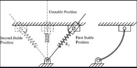

Hi. I have a application for a bistable spring mechanism. But my problem is that all of the ones i have seen require to go past the "midpoint" before it flips to the other side. Is there any such mechanism that flips over to position 2 before you get to the "midpoint" from position 1?
Example of the mechanisms i have found:
The problem as stated is that you have to go past the "unstable" position in the midpoint before it flips over. What i want is 2 "unstable" positions depending on what side the "switch" is currently on where the "unstable" transition point is closer to the current point of the "switch" than the midpoint.
The mechanism can be rotary or linear, that does not matter for my application.
Not sure if this works, I can get my brain only half way around it!
Referring to the approach in the right side of your figure, I'm assuming the curved link is a "too-long" leaf spring that is always curved. How about attaching two coil springs horizontally to the approximate center of the leaf spring, pulling left and right? The coil spring forces will always be unbalanced trying to pull the leaf spring overcenter, but not enough to do so by themselves.
Success of this approach probably depends on the inertia of the leaf spring and the moving load... (haven't really thought it thru in detail.)
Let's see if anyone can build on the idea to make it useful.
Cheers,
Tom

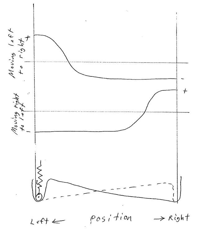

I sounds like you are trying to move something back and forth between defined endpoints, with stable positions at each end, and an overcenter force near the current position of the something. The top two push force vs displacement plots in the figure below show what I mean:
When the something is in the left position, it takes a push to start it moving, then after a short distance the push force becomes negative and it moves by itself to the far right position. Similarly, when it is in the right position, it takes a push to start it moving, then after a short distance it moves by itself to the far left position.
A partial mechanism to do this is sketched in the bottom of the figure. Two cam tracks, one behind the other. Each cam track has its own cam follower. Some sort of rocker as alluded to by @Baluncore in Post #14 would switch between cam followers at each end of travel. That switching action would take some energy. That energy would come from the kinetic energy of the something hitting the end stop.
It's a partial idea, maybe somebody can figure out a switchover mechanism.

That is what i am after.
But i don't particularly like the track and cam idea (but that is the same possible mechanism that was the only one i could think of too). I like a linkage mechanism better (more robust and simple). And the switchover mechanism (for selecting between the two tracks in the case of your drawing) needs to be solved in a simple manner (i don't want a too complex mechanism for my application, as i want to keep it simple to be both robust, inexpensive to make, and have minimal amount of failure points)
The reason i prefer a linkage approach over a track and cam approach is:
  • With track and cam there will be side forces on the spring part. While with a linkage mechanism there will be minimal side forces
  • With track and cam you have to have a bearing on the cam part for rotation. That bearing can be filled with stuff and fail, while on a linkage system you can use simple plain bushings in the link joints. And a bearing is also more complex and expensive.
  • With track and cam loose objects can get wedged between the cam wheel and the track stopping the mechanism from working, or even breaking the mechanism. While on a linkage mechanism this is mostly not a possibility.
  • The track can become dirty making the cam run rough or even fail to work.
  • The track and cam surfaces will wear more over time i think than the bushings in a linkage mechanism.
My application is in a marine environment so corrosion and dirt and debris is a big concern. That is why i want it simple and robust.
