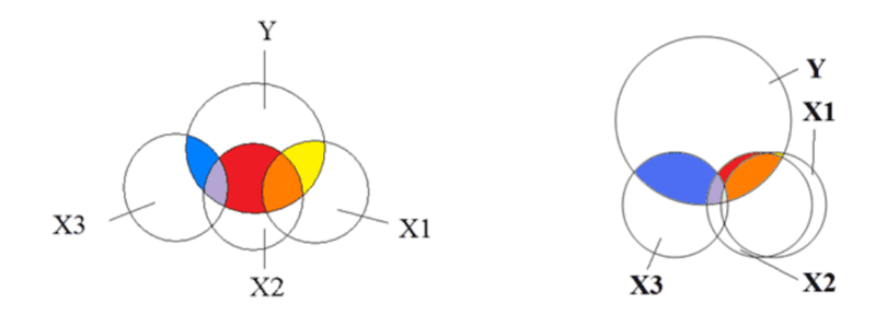

In a visual sense, using Venn diagrams, how can the predictors be correlated all together if they are not pairwise correlated at all? The figures below show moderate multicollinearity and strong multicollinearity. I don't see how the ##X## circles cannot overlap and still cause multicollinearity...
It may depend on how low you demand the individual pairwise correlations to be. Suppose that ##X_1## and ##X_2## are independent, identically distributed random variables and that ##Y = X_1+X_2##. Then I think it is clear that the correlation of ##Y## with any one ##X_i## may be smaller than the threshold even though ##Y## is a deterministic function of ##X_1, X_2##.
In fact, it gets easier when ##Y## is a function of more independent ##X_i## variables. Any one ##X_i## might have a low correlation with ##Y## but the combination of all the ##X_i##s might completely determine ##Y##. Suppose ##Y = X_1+X_2+...+X_{100}##, where the ##X_i##s are pairwise independent.

Processing...multicollinearity is when the predictors are correlated in such a way that the estimated coefficient for a predictor, which would indicate the change in ##Y## per unit change in ##X##, is not what it is really is because ##X_1## and ##X_2## are correlated so when ##X_1## changes by one unit we cannot hold ##X_2## fixed and it changes too...
Let's say ##Y=b_1 X_1 + b_2 X_2 + b_3 X_3##...and the predictors ##Xs## are pairwise linearly independent with the correlation coefficients being low: ##r_{12} = r_{13} = r_{23} \approx 0.2##. That is not an automatic proof of lack of multicollinearity...
It could be ##r_{123} \approx 0.8##... But could that be? How can they collectively be more correlated than pairwise? I am struggling to see that, especially visually using the Venn diagram where each smaller circle represents the variance of ##X## and the larger circle is the variance of ##Y##...
Oh, maybe I get it now...It could be that ##Y=\beta_1 X_1 +\beta_2 X_2 + \beta_3 X_3## and the three regressors are pairwise uncorrelated to each other BUT the correlations between ##X_1## and, for example, the variable given by the sum ##X_2+X_3## to be nonzero and high in value. Same goes for the correlation btw ##X_2## and ##X_1+X_3##, etc.
I think that is what the variance inflation factor (VIF) does in checking these correlation combinations, which cannot be visualized with the Venn diagrams of the individual predictors and response variables, instead of focusing on the pairwise correlations...

Not if the ##X_i##s are independent. Then ##X_1## would be uncorrelated to ##X_2+X_3##.
I probably should leave this for others since I am not an expert. But if ##Y = X_1+X_2##, where the ##X##s are independent, then ##Y, X_1, X_2## are all estimators of ##Y## to varying extents. ##X_1## and ##X_2## are independent. ##Y## is somewhat correlated to an individual ##X_i##, but completely determined by the pair. The more ##X_i##s there are in the sum, the weaker would be the correlation between ##Y## and the individual ##X_i##s.
