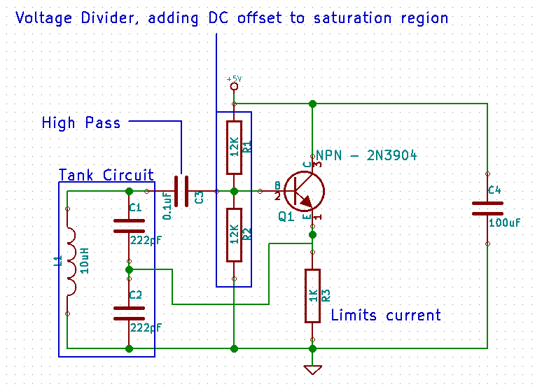

TL;DR Summary
I have trouble finding the amplifier gain of this colpitts oscillator.
This is a BJT common collector colpitts oscillator.I have found how to find the feedback fraction from this site:http://fourier.eng.hmc.edu/e84/lectures/ch4/node12.html but I have searched for hours and haven't found the amplifier gain of this circuit.
I have found the amplifier gain for similar colpitts oscillators with a collector resistor and the output of the circuit is the collector voltage but not for this . Help appreciated!

Well - the output node of the gain stage in common-collector configuration is - of course - the emitter. But for answering your question one must know which "gain" are you interested in? I suppose, you know that the "open-loop gain" (without the feedback network) is simply Aol=gm*R3/(1+gm*R3), which is very close to unity.
But this is just the most simple part of the problem.
Most important is the loop gain (gain around the closed-loop), which gives you the condition for oscillation and the oscillation frequency.

Under open-loop conditions the load is given with the emitter resistor only.

The capacitor you show as a high-pass filter is there to block the DC. You can reduce the value of that capacitor to get improved stability. That is because it reduces the amplifier load on the tuned circuit.

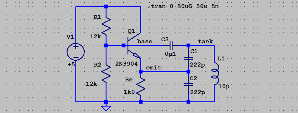

If you post your LTspice.asc.txt file, I can break the loop or parallel your circuit to show model the amplifier gain.

Assuming high transistor gain, and ignoring second order stuff, the voltage gain of an emitter follower is 1. As in post #2.

ok but what is the impedanve of the load?It isn't just the emitter resistor is it?How C1 and C2 contribute to the impedance of the load?

At the resonant frequency the tank impedance is very high (since there are essentially no losses shown). So, at that frequency, we would normally assume there is no additional load across the emitter resistor. At other frequencies, or to get an exact solution, is an algebraic nightmare, you have to include lots of parts. You can't just look at C1, or C1 & C2, because all of those parts have similar magnitudes at the frequencies of interest.
For the resonant tank part, if you are far away from resonance, then you will find that either the inductor, or the capacitor can often be ignored because their magnitudes are very different.

Also the DC bias resistors R1 & R2 are 6Kohm of parallel load on the tank. Since the tank characteristic impedance Zc = √(L/C) = 300 ohm, the 6K in parallel will limit the Q = R/Zc to less than 6K/300 = 20. Also the output impedance of the amplifier (R3), etc. The exact solution is complex.
These circuits are almost always analyzed by making some assumptions to simplify things. Like ignoring the loading of R1 & R2 because Q=20 is almost the same as Q=∞. We know those assumptions are approximations, once you get a simplified model looking OK, then you can go back and see if you really do care about some of those details we skipped over.

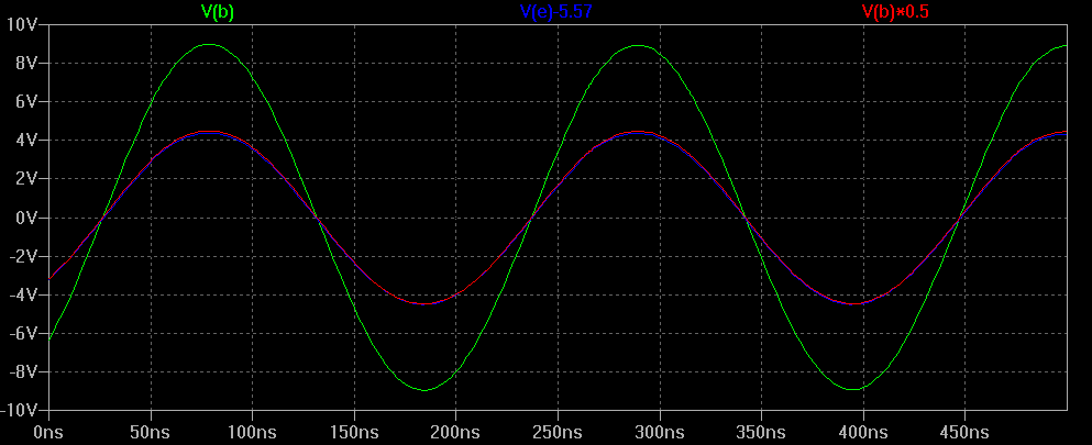

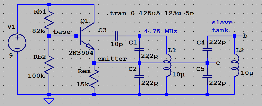

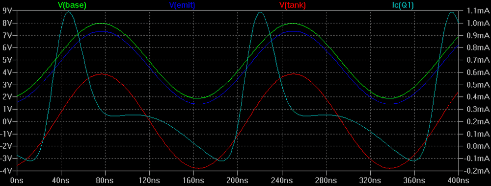

Model another tank circuit, identical to L1, C2 and C3. Connect the lower end of L2 to ground. Connect the centre of the two capacitors to the same emitter drive terminal on the existing modeled oscillator. The simulation should run with the tank circuit slaved in parallel without any big change to the simulation.
The top of the slave, L2 is disconnected from the base terminal. Look at the sine wave on that terminal and compare it to the emitter voltage. You will see that for C1=C2, the voltage ratio is exactly two.
The L1-C1-C2 tank acts like a centre tapped transformer winding = an autotransformer. That provides the voltage gain of two required to sustain oscillation.
The BJT is a buffer amplifier that converts a high impedance at the base terminal, to the low impedance at the emitter terminal. In effect it has a current gain.
The emitter resistor can be increased to 15 kΩ, and there is less distortion with a higher base bias impedance and a smaller feedback capacitor = 10 pF.
The base impedance is then about 40 kΩ. The output impedance of the emitter follower is about Re / β ≈ 100 Ω.
Here is the schematic with the plot of base and emitter voltages.
Note that Ve with offset is plotted in blue, over Vb/2 in red.

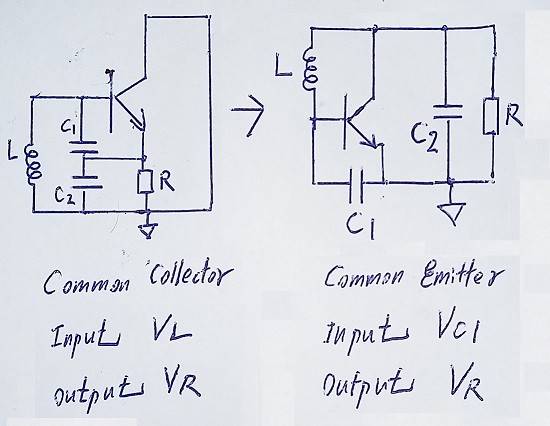

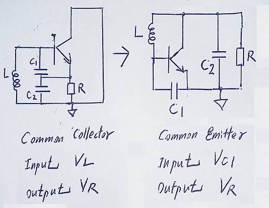

I have attached a diagram showing how the circuit may be regarded as common emitter.
I am not convinced. The transistor is operating as an emitter-follower, which really makes it a common collector configuration. The base is the input, the emitter is the output.
I think people are assuming emitter follower because the circuit is drawn with the collector grounded for RF. That does not make it common collector. The ground can be placed anywhere on an oscillator circuit.
No - we are not "assuming" something. The circuit is indeed an emitter follower - the collector is at signal ground and the emitter potential is "following" (with a very small error) the varying base potential. What else do we need to call it correctly "emitter follower"?
And yes - you are right. We can make use of the "virtual ground" concept as proposed by Alechno long time ago. This is a good method to convert the shown circuit into a common emitter stage (gain>1) with a frequency-dependent positive feedback path. In some cases, such a conversion can help to better understand the function of some circuits.
But without such ground shifting the given circuit remains what it is: A common collector stage (emitter follower).
Nope. Lots of incorrect network manipulations between steps 2 and three.
I can't buy it either. I'm surprised anyone would attempt to claim such a thing.

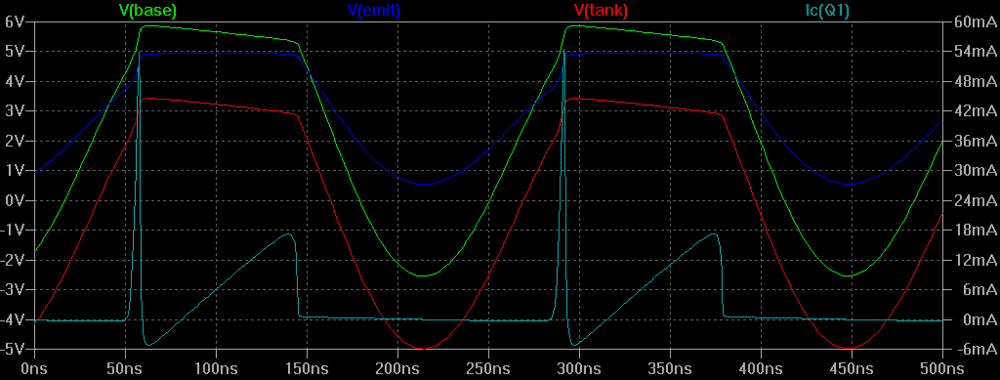

I believe that treating this oscillator circuit as a common emitter configuration is not completely unreasonable. At least for now, I can't think of a reason to absolutely deny it. Although I really don't know whether this view would violate basic theory or principle. 🤔
In any case, whether we treat it as CE or CC, the working process of this circuit, the current and voltage of each part in the circuit will not change as a result. :smile:
Are you saying for the input that VL = VC1? I don't think can be correct.
Of course, the voltage values of L and C1 in the circuit should be different. What I mean is that as long as the input and output are defined correctly as shown on the diagram I posted, then it seems that it is no problem to call it CE or CC.
