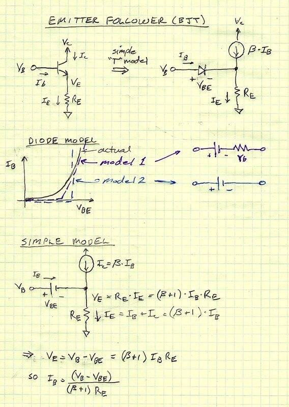

- This thread is about the negative feedback of a emitter follower circuit
Assume we have a common collector circuit with a emitter resistance of 1k Ohms.Vc = 10V Ve is connected to ground.
Now we connect the base of the transistor to 5V . The base current will be 5-VBE/1000 Amp.Let's say a voltage drop of 0.7 in the BE junction .We will get Ib = 4.3mA.
Ic = bxIb = 100xIb = 430 mA. Now the voltage drop on the diode becomes 0.43x1000 = 430V . How is that even possible?The BJT must saturate and emitter resistor must have a voltage of 9.8V . But by not putting a base resistor , the BJT saturates?
Even if we put a base resistors the voltage at the emitter current seems to be increased. What is happening?
