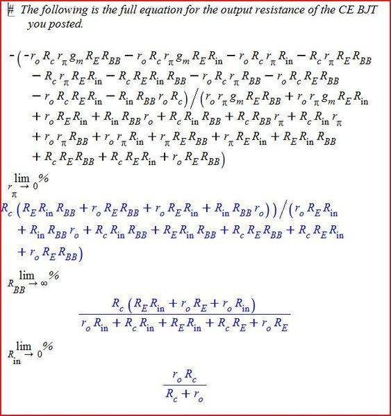

eliotsbowe,
To derive the output resistance, I'd write the following KCL:
ix=irc+ic
at this point, every example I've seen says Ro=Rc, that is: the collector current is zero.
May someone please explain me the reason for this statement?
Why do you say the collector current becomes zero when Rc=Ro? Rc is part of Ro.
If you want to see the full equation for the output resistance, look at the attachment. As successive terms are set to zero or infinity, the equation simplifies. Finally, as ro becomes infinity, the output impedance becomes simply Rc.
Ratch
