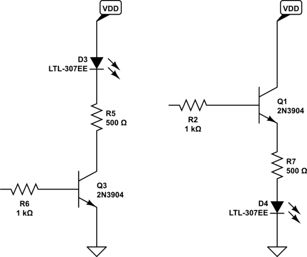

Here are a couple of BJT LED drive circuits that you can start simulating...
http://i.stack.imgur.com/OnVwa.png
And a Common-Emitter amplifier stage like above will have a V-I characteristic like this:
http://sub.allaboutcircuits.com/images/quiz/02244x01.png

Thank you Dave, silly mistake thinking that the light probe was multisims version of the LED. After changing that and adjusting the components to their original values everything worked as expected.
Likes davenn
cool :smile:
look at the variations that berkeman also posted
