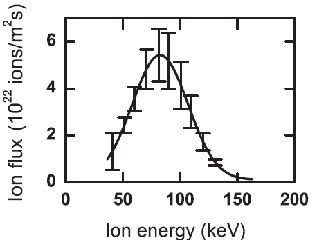

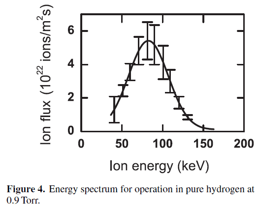

Just want to know if possible to have a high energy MB dist. as in Fig 4 of the attached paper, and if yes how it is justified?
  • Ion_beam_emission_in_a_low_energy_Plasma_Focus_dev.pdf
Hereby I officially declare myself as unqualified to respond in this thread :smile:
But if you want my opinion: In the first link the abstract is rather ominous
Abstract
A detailed and precise study of high energy deuteron beams from a plasma focus device shows that they follow a non-power law distribution, unlike most of the other works. This is in agreement with our previous studies using a direct and unambiguous diagnostic of the activation yield-ratio technique. It is possible that the En dependence effectively terminates at some maximum deuteron energy. The experimental results show that the spectrum increases to very high energies whereas the power law fit fails.​
So at least the notion of uncharted (or poorly charted) territory emerges. From the fig 4 in the attachment :
I personally wouldn't like to claim any preferred underlying distribution.
Anyone more introduced to the subject ?

Is it physically possible at all to have MB distribution for an electric discharge in the gas (not raising the temperature), and it is similar to the figure above (peaks at 75 keV and ends at 150 keV)?

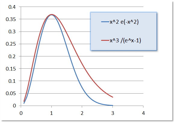

As I said the formula is much the same as MB and more than that:
1. the total power is equal to the power forth of potential
2. the peak occurs at value of potential itself
these are similar to the BB radiation:
Everything looks identical, but I am not sure how physics justify it?
