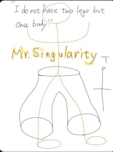

The questions regarding a BH merger posed by @mitochan and @Grasshopper are assuming singularities. But what if physics "breaks down" at ##r=0## as most physicists are thinking? What if the mass exists in finite density in the center in a yet unknown state?
Could we still say there aren't two centers?
Likes Dale

I draw a sketch for better understanding at attached.
Your sketch is incorrect. The topology of the singularity is a single spacelike line, not one line that branches into two.
Likes mitochan
