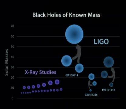

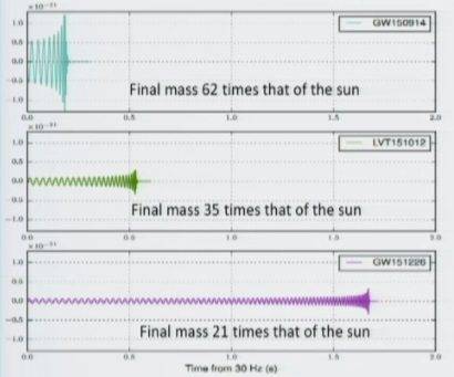

Just saw one more suggestion for you coming out of todays AAS press conference on black hole mergers. Not sure if you can do these, but they would be fun to watch. :)
I'm afraid that is firmly in the realm of Numerical Relativity, which is well above my pay grade! If you want to watch something here is a typical simulation. This is on-topic because these are the sort of simulations that LIGO use to generate template signals for matching against their observations.

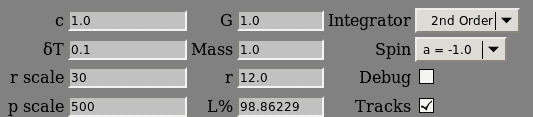

First a couple of questions; are you using proper time as your integration variable, and are you using a variable step integrator?
I suspect what you are seeing might not be "freezing" at the horizon, but your integrator reducing the time step towards zero as the (coordinate time) error increases towards the horizon.

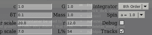

I just verified that if I don't stop my HTML simulator at the horizon, it goes all the way to ##r = 0##. You can try changing my models.js file line 275 to
Code:
        if (this.r > 0.0) {
And see for yourself with these parameters:
If you watch the times, you should see the coordinate time increase up to the horizon and decrease slightly inside, whilst the proper time just ticks away merrily until the end.

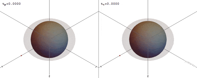

The equation of motion differentiates coordinate distances by proper time (so internally the rapidity, which is infinite when v=c and imaginary when v>c, not the velocity is used). When I plot orbits that don't get near the event horizon I use a standard Runge Kutta or even automatic variable step size at MachinePrecision because it is much faster but accurate enough when the trajectory doesn't tipple the horizon and not too many revolutions where the small errors could accumulate are plotted. When the particle gets near the event horizon I include a StiffnessSwitcher and when plotting in coordinate time steps also an increased WorkingPrecision for the last micrometers before the event horizon.
The same scenario in proper (left) and coordinate (right) time steps:
(The local initial launch angle of 85.5° seems flatter since the radial shell distances are contracted relative to the circumference, which is a strong effect at r0=2.002GM/c²)

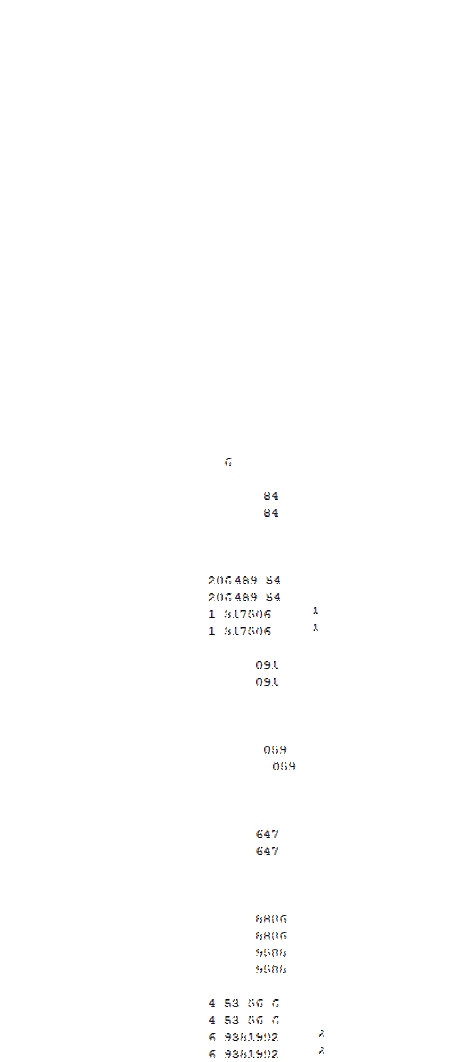

If you trace the test particles world line this are the numbers you shoud get for the coordinate time, but inside the horizon they are not meaningful physically for an outside observer:

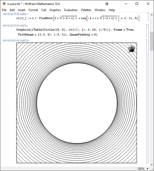

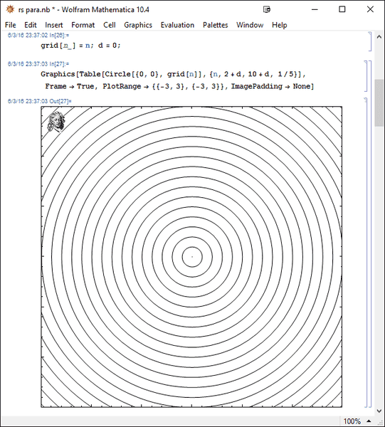

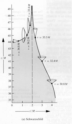

To understand why the local launch angle of almost 90° in my last posting seems like almost flat in Schwarzschild coordinates one has to look at Flamm's Paraboloid:
where the x-Axis represents the radial distance as it is seen by a coordinate observer, and the true number of rulers is the one that would fit on the blue graph; so between the coordinate r1=2GM/c² and r2=24>GM/c² there fits a ruler not of length r2-r1=22GM/c² but of length ∫(1/√(1-rs/r), r=r1..r2)=26.8GM/c². The same goes for the velocity components, so a grid that would look like this:
with Newton would look like this in Schwarzschild coordinates:
On the shell ar r0=1.001rs where the test particle is lauched the radial component is contracted by a factor of more than 30 relative to the transversal component. That's why an almost straight up launching angle seems like an almost flat angle for an external observer.

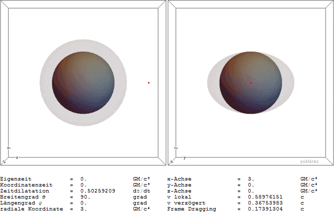

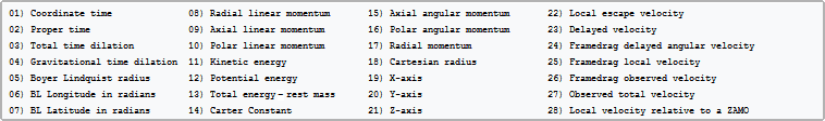

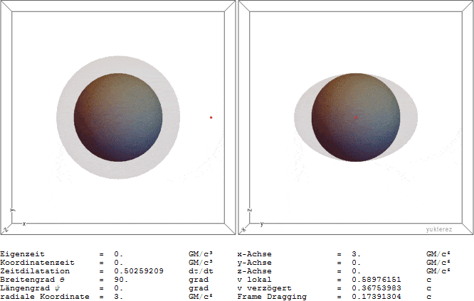

I finished the simulator for rotating black holes using Kerr metric.
It takes intial positions in terms of {r0, θ0, ψ0} for radial distance and polar and spin angle, and initial velocities in terms of {v0, δ0, φ0} for total velcity and horizontal and vertical launch angle, or alternatively {vr, vθ, vψ} for the separate components.
Initial conditions:
Spin parameter: a=0.998, r0=4GM/c², initial position of the test projectile: θ0=90° (equatorial plane), horizontal launching angle: δ0=60° in south pole direction, vertical launch angle: φ0=0° (horizontal), local inital velocity: v0=0.6c
Top, side and front view relative to the spin axis of the black hole:
http://yukterez.net/org/kerr4.gif
It still needs some updates to have the same displays as the Schwarzschild-simulator which I will do when I have the time (hopefully soon).

Nice. If you were to keep track of and display the max and min r values, and the maximum latitude, we could compare notes ;)
You can also compare against http://staff.science.nus.edu.sg/~phylyk/downloads/reports/sp2172_report.pdf for particle orbits, and this for light orbits.
That's next on the list, and also the local and delayed velocities as well as the time dilation factor.
The latitude goes over all values, as seen in the right image (as well as the longitude, which is seen in the left image)
Yukterez said:
That's next on the list, and also the local and delayed velocities as well as the time dilation factor.The latitude goes over all values, as seen in the right image (as well as the longitude, which is seen in the left image)
You might want to reconsider your last statement, in the light of the top view on the left ;)
Anyway, this will become more explicit when you implement the latitude detection . . .
BTW this and this is what I mean by a maximum latitude/polar orbit.
  • #31
That's why I went online again, after thinking about it it became clear that this was an error.
  • #32
Heh, I realize you know your stuff, just proving that I am awake!

The most important values are now displayed below the animation (I call it "the butterfly", because with a little fantasy you can see one in the right image with the polar perspective):
http://i.imgur.com/5LuDiKl.gif
Unfortunately I did the index in german, but the latitude is the "Breitengrad θ" with 0° for the north and 180° for the south pole.
Edit: the picture embedding does not seem to work (maybe the gif is too large, the running numbers cost an extra megabyte) but if you click on the icon you should see it.
