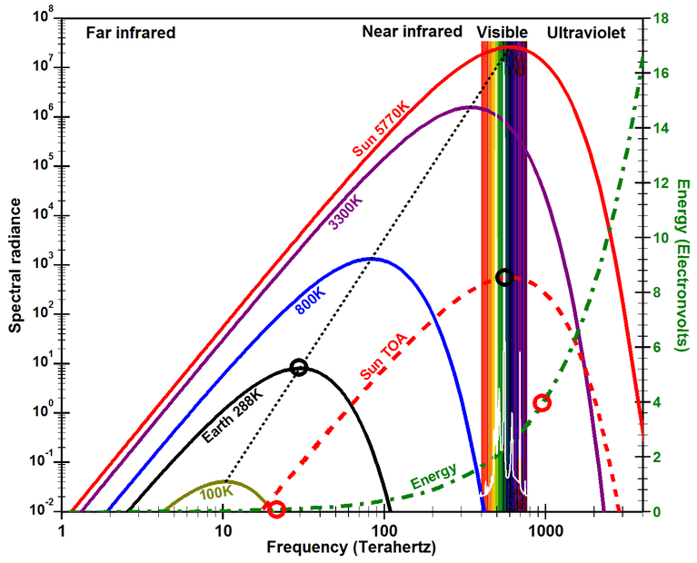

Question 1:
The quote above says that at room temperature (let's say 20 C or 293 K) the emission is in the infrared region. You can see in the figure below, lower curve, that at temperature of 37 C (little higher than room temperature), the curve extends well into longer wavelengths such as microwave and beyond. Is it really true that a blackbody at 37 C radiates microwaves and radio waves etc. as shown in the figure below? I don't think so. Then, why is the curve shown this way?

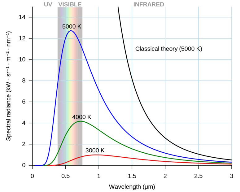

Most of the time I haven't seen that the size of blackbody is mentioned. For example, if sun is approximated as a blackbody, its temperature is almost 5800 K. There could be another blackbody of tennis ball size which is also at temperature of 5800 K. I don't think that power radiated by them is the same. The tennis ball size blackbody will radiate less power. The figure below uses spectral radiance units, kW/(sr.m^2.nm), but the figure above, used for Question 1, uses power density units, watts/m^3.
Which unit is more descriptive? Why size is not mentioned? Perhaps, the unit conveys this information indirectly.
Why are you skeptical? (I am not saying you are wrong, I just wonder about your thinking process here.)
Spectral radiance is the direct result of the Planck distribution, which a distribution function and hence made to be integrated.
The unit ##{\rm W m^{-3} }## is rather confusing. It would be clearer to use ##{\rm nW~m^{-2}~nm^{-1}}## because it's power per unit area per unit wavelength interval. It differs from the other quantity in that it is an integral over solid angle.
I agree with you.
I was already confused about the unit W/m^3 in this context since this unit was used in the figure used for Question 1 along y-axis.
Two pearls of blackbody wisdom. Consider the blackbody spectrum as a function of frequency (ie ##\frac c {\lambda} ##). The peak of the curve shifts linearly with T and the height of the curve grows as ##T^3## from which $$Integrated Emmittance=\sigma T^4$$
So hotter objects peak more towards the visible but they are a lot brighter also. Also be aware that light by itself does not really interact so to talk about Temperature you really need a box at T .

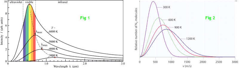

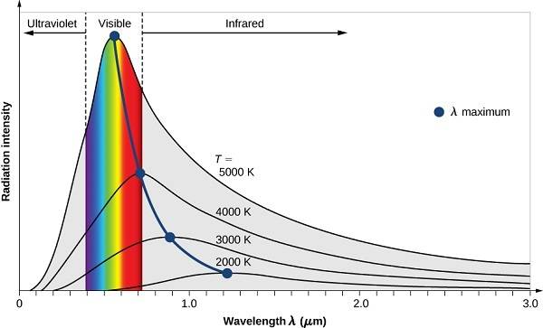

Source: https://en.wikipedia.org/wiki/EmissivityI like the blackbody spectrum shown below. It does not seem to extend toward infinity.
Source: drive.google.com /file/d/1-7N41adtomur-L8c-lat0UmVCiScTsJl/view?usp=sharing
This source, https://ase.tufts.edu/cosmos/view_picture.asp?id=1332 , also such a spectrum which doesn't extend toward infinity.
Is it spectrum shown above assuming emissivity of less than 1?
If spectrum of a blackbody peaks at, say, frequency of f=10 kHz at temperature of 400 K. How will such a spectrum relate to a non-ideal blackbody at the same temperature of 400 K? Will the spectrum of the non-ideal blackbody also peak around f=10 kHz but the intensity goes to almost zero for limited range of frequencies around f=10 kHz?
Thank you for the help, in advance!
Likes 256bits
It does, you are just fooled by the axes
Note the logarithmic scales on the axes. You can go down vertically how much you want, there is no limit.
Likes dextercioby, PainterGuy and Lord Jestocost
That's because of the vertical scale. There are no units marked on the y axis. The formula includes an exponential term and there is no value of x for which ex is zero

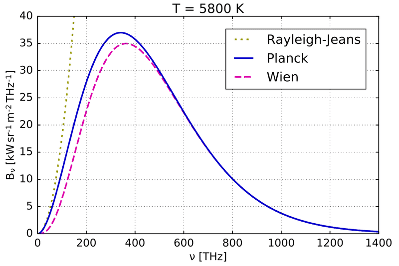

The figure below shows the comparison of Rayleigh–Jeans law with Wien approximation and Planck's law, for a body of 5800K temperature.
Source: https://en.wikipedia.org/wiki/Rayleigh–Jeans_law
Planck's Law is more accurate, then comes Wien's Law or approximation, and the least accurate is Rayleigh-Jeans Law.
