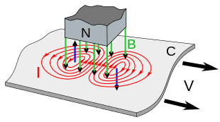

Hi everyone - here's a concept that I'd like a few opinions on:
As part of a project, I'm looking at using a brushless DC motor mounted on a high-speed vehicle as a generator. Once the vehicle hits its top speed, the batteries should disconnect from the motor and the vehicle's own velocity will cause the motor to generate an AC current (through wheel rotation). This current would then be rectified and used to power EM eddy current brakes that slow the vehicle down far enough that disc brakes can be used. The end goal here is to calculate a braking force curve as a function of motor rpm.

Thanks for the reply! I'm completely mistaken about the DC motor generating an AC current - it would be DC output. The eddy current electromagnets... my gut tells me that using them like permanent magnets in a linear eddy current brake would work, much as is seen in some trains. Thanks for the questions - should I make an edit in the original post to reflect this?
I think the original post is fine, since you are clarifying it. Can you post more about the linear eddy current braking system? I guess if you put a DC magnetic field across only a part of the rotating disk, that will create the changing spatial magnetic field zone that does give eddy currents. How would you optimize such a geometry to give the best braking force? How are you planning on cooling the discs? From your New Member Introduction post, it sounds like you will be slowing down a train that is moving pretty fast...

The eddy current brakes will put a DC magnetic field across a rail moving at high velocity (so no discs) - the same rail which our craft is riding on/attached to.
So more like this geometry:
or
Cooling then isn't as big of a concern right now because the rail is rather massive and long.
I am worried about outrunning the eddy currents in the rail and thus losing braking force
