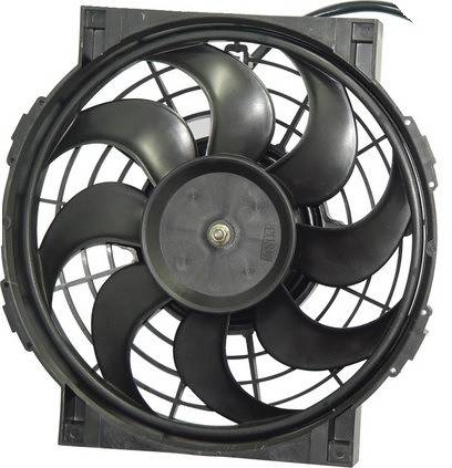

I'd study the blades on automobile radiator fans.

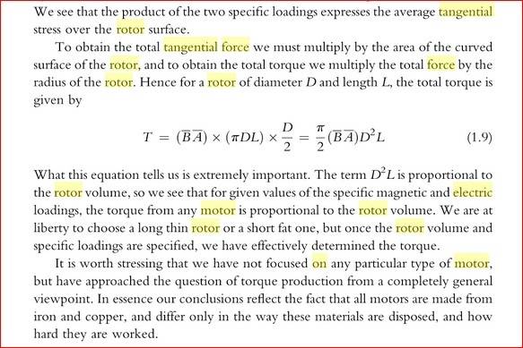

Found by searching on terms 'tangential force on motor rotor' an online book on the subject
https://books.google.com/books?id=jjuTYtKokc8C&printsec=frontcover#v=onepage&q&f=false
here's a snip from it
https://books.google.com/books?id=jjuTYtKokc8C&pg=PA17&lpg=PA17&dq=tangential+force+on+an+electric++motor+rotor&source=bl&ots=RsXIXBCn3z&sig=pUK-g2iKCQ6ITeT6TskpwbyYzAU&hl=en&sa=X&ved=0ahUKEwiQ1Mu46czSAhVi4IMKHWiADQYQ6AEIMjAD#v=onepage&q=tangential force on an electric motor rotor&f=false
A is current density which is one way to express the strength of permanent magnets.
That's a basic principles approach against which you should be able to cross check those formulas from your RC motor books.
That book answers an old question in another thread about effect of slots on armature conductors that's had me stumped, even my old college prof didn't have a good answer. Thanks for causing that serendipitous discovery!

By the way, any idea what the B in this formula may refer to?
Surely it's flux density
i didn't read far enough to see if it's SI Teslas or cgs Gauss .
