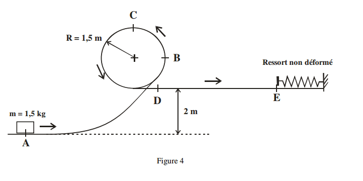

A block of mass m = 1.5 kg is launched from point A with speed VA = 12 m / s, in the circuit
shown in Figure 4. If we assume that there is no friction determine:
a) the speed of the block when it reaches the point C;
Drawing of the problem:
http://i.imgur.com/TrcMJ5I.png
This question has about 10 questions but I only want to really understand the first one and I would like your help with this because its very confusing me since the ramp is curved and not straight plane like usual.
Also the circular part is confusing me a lot too.
Do I have to use the conservative energy formula to find the final speed to C ?
I am very sorry I don't have anything as my own work (try) but I really do not know how to do this.
I have never posted a help thread before without any work done.

What is the initial Kinetic Energy of the block?
What is the change in potential energy of the block in going from point A to point C ?

Ek = 1/2*m*vi2
Ek = 1/2*1.5kg*12m/s
Ek = 9J
Ugf-Ugi = m*g*hf - m*g*hi
(1.5kg*9.81*0) - 1.5kg*9.81*(2m+1.5m)
= -51.5025J

You didn't square the velocity for kinetic energy.
You have the potential energies reversed. UC - UA is positive .

sorry my bad.
Ek= 108J
and potential energy is 51.5025J
Then I use this formula to find the Vf?
Ugi+1/2*m*vi2 = Ugf + 1/2*m*vf2
108J = 51.5025J+ 1/2*1.5Kg*vf2
vf = 8.67929m/s

Then
b) the centripetal acceleration ( normal) in point C;
I would simply do this?
ac = v2/R
ac = 8.679292/1.5
=50.22m/s2
c) the normal reaction exerted by the loop on the block at point C (Draw the diagram of the forces and acceleration) ;
Do not really understand this.
Would N be the same direction as W in this situation since the block is under the plane.
Forces in Y = 0 = - N - W
= 0 = - N - 1.5*9.81
N = -14.715N
Yes, but the following is not correct. The acceleration is not zero. See part (b).

You assumed the normal force was downward, but the result came out negative, which would make the normal force be upward.

http://i.imgur.com/jzuoGuC.png is my diagram of forces and acceleration correct?
If that is correct then I can do this:
Forces in Y = - m*ac = - N - W
Forces in Y = - (1.5kg*50.22m/s2c) = - N - (1.5kg*9,81)
now my N is 60.615N
is that correct?
Thanks for helping me, I really appreciate it :)

No. Gravity is downward. The fact that N turns out to be upward came from you ignoring centripetal acceleration. If the block were to remain stationary on the bottom side of the track at point C, then the track would have to exert a force upward to compensate for gravity.

That is a correct method. Looks good.

Now to find :
d) the speed of the block as it passes under D and E;
For D:
Ugi = m*g*hi = 1.5kg*9.81*(2+1.5) = 51.5025J
Ugf = m*g*hf = 1.5kg*9.81*(2) = 29.43J
Eki = 1/2*m*vi2 = 1/2*1.5kg*8.679292 =56.4976J
Ekf = 1/2*m*vf2 = 1/2*1.5kg*vf2
Ugi + Eki = Ugf +Ekf
51.5025J + 56.4976J= 29.43J + 1/2*1.5kg*vf2
vf = 10.2352m/s ---> D
and now for E;
Ugi = m*g*hi = 1.5kg*9.81*(2) = 29.43J
Eki = 1/2*m*vi2 = 1/2*1.5kg*10.2352m/s2 =78.5695J
Ugf - Ugi = 0
Eki = Ekf
78.5695J = 1/2*1.5kg*vf2
= 10.2342m/s
normal that my speed is the same ? there is no acceleration I should add somewhere :/?
thanks.
