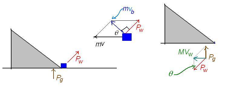

I join to AlephNumbers and Collinsmark. During the first short period, when the block makes contact with the wedge, the velocity of both the block and wedge change, because of the impulsive normal forces between them and between the Earth and the wedge. The block gets some impulse, perpendicular to the slope, and the wedge gets a horizontal impulse.
If the block is point-like, those normal forces can account for, see picture.
Pw is the impulse between wedge and block, Pg is that between the wedge and ground. The momentum of the block becomes mvb=mvcos(θ) and Pw=mvsin(θ). The momentum of the wedge is MVM=Pwsin(θ)=mvsin2(θ).
The horizontal component of the total momentum is equal to mv, the momentum before collision. But the energy is not conserved during this collision.
If there is a smooth transition between the ground and the wedge, the energy can be conserved, but theta changes during the collision. We do not know what the speeds are when the block reaches the flat part of the wedge.

Impulse makes this whole thing so much easier and simple to understand. So I need to consider the ground into the wedge and block system if I want to calculate the linear momentum at the point of collision.
So I can say that the block goes up the wedge at vcosθ at the point of collision.
I assume is the horizontal momentum you are talking about?
mv = mvbcosθ + MVw
So Vw = mvsin2θ/M at the point of collision.

I talk about the "instantaneous collision", when the block had no time yet to raise on the wedge, and the energy is pure kinetic. After that, the energy is conserved, some part of KE transforms into PE.
Why is the energy not conserved at the point of instantaneous collision? Isn't the initial kinetic energy = 0.5mv2 and the total kinetic energy at the 'instantaneous' collision = 0.5mvb2 + 0.5MVw2
vb2 + Vw2 = v2cos2θ + vsin2θ = v2 which is an elastic collision at the 'instantaneous' collision where ΔK = 0
KE=0.5mvb2+0.5 M Vw2, and
vb=vcos(θ), VM=(m/M)sin2(θ)
KEis not equal to 0.5mv2.
Isn't VM = mvsin2θ/M
So it does not conserve energy because the change in kinetic energy has not yet changed to potential energy at that moment?
You can ignore the surface/block connection - a block hitting the wedge horizontally at some point above the ground would give the same result (assuming the wedge does not fall over).
collinsmark said:
If you can make the argument that the all the extra energy of the collision goes into the gravitational potential energy of the block (which, in the end, rests atop the slope), then this should be a pretty easy problem to solve.
You cannot, the collision will have an inelastic component - otherwise the block would fly into the air and not stay on the ramp (easy to see for very large M but true for all).
Horizontal momentum is conserved (no friction at the surface) and relative momentum parallel to the wedge surface (block as seen by wedge before and after collision) is conserved (no friction at the wedge surface). Those two constraints allow to find the two unknown parameters after the collision, like wedge speed and horizontal block speed.

If you assume there is a little curve at the start of the ramp going from horizontal to the angle theta, so that no work is lost in impacts.
If there is a curve at the start of the ramp (smooth transition) means that the normal force of the wedge on the block is always perpendicular to the velocity of the block thus no work is done on the block. Which also means that the block towards the wedge at u, and move up the wedge at u.
If there is no curve at the start of the ramp (not smooth transition) means that the normal force of the wedge on the block is not perpendicular to the velocity of the block thus there is negative work done on the block, so the block will travel up the wedge at a velocity less than u.
Is my understanding of the situation correct?
If you mean the velocity of the block immediately after the transition in each case, yes.
Okay thanks. So if the question did not state anything about the transition, which case should I consider?
As I wrote in post #13, from the statement of the question I would have thought there was an inelastic impact, i.e. mfb's view. It is only by seeing the given answer that we are able to infer that the question setter intended a smooth transition.
