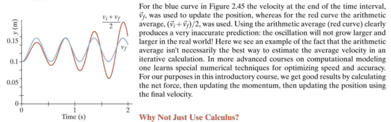

Well while I was waiting, I continued reading in the book and I may not be understanding them, but they seem to my question themselves and then respond that it is less accurate. and they show a graph that the method I used is less accurate over time. I am currently seeing if my python skills will allow me to test that.
Am I understanding this correctly. my method with the acceleration ought to be equivalent to calculating (Vf-Vi) / 2, right?
edit: I don't know. I can't get my program to plot properly.

I put the two methods and a cos function into a spreadsheet.
After a quarter of an oscillation, approaching the equilibrium point, the cos function has a displacement 0.011; your method has -0.004; the book has -0.019. So at that stage you have the more accurate displacement.
But tracking the energy, the book method lost a bit of energy to begin with, then pretty much got it all back by the quarter cycle point. Your method had smaller changes, but all in the positive direction.
So although your method is more accurate over shortish stretches, the errors accumulate.
I have a suspicion that motions other than SHM could work better with your method, but I need to do more analysis to figure out what is happening.

Suppose the motion is ##y=\cos(\omega t)##. We can consider how two simulation algorithms update y and velocity over a time step ##\delta t## and compare the resulting error accumulated in the total energy.
To simplify matters, I only compared using the prior velocity to update the displacement with using the posterior velocity. Using the average velocity presumably gives a result between the two.
Using the prior velocity gives ##\delta E=\frac 12\omega^4\delta t^2##.
Using the posterior velocity gives ##\delta E=-\frac 12\omega^4\delta t^2\cos(2\omega t)##, plus terms in higher powers of ##\delta t##.
Since these are equal and opposite at first, using the average velocity starts out looking best.
But note what happens summing over a cycle. The error in using the prior velocity is always positive, so accumulates without limit, whereas the error in using the posterior cancels. Remarkably, even the next term, ##\frac 14\omega^5\sin(2\omega t)\delta t^3##, cancels, leaving only ##\frac 12\omega^6\cos^2(\omega t)\delta t^4## to accumulate.
