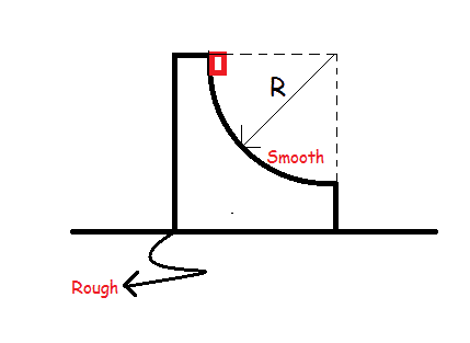

Consider a wedge of mass m whose upper surface is a quarter circle and is smooth. The lower part is rough. A small block of same mass is kept at the topmost position and the initial position is shown in figure. The block slides down the wedge.
Find the minimum value of coefficient of friction between floor and lower surface of wedge so that the wedge remains stationery during the block's motion on it.
I tried to find the angle 'theta' at which horizontal force on the wedge is maximum.

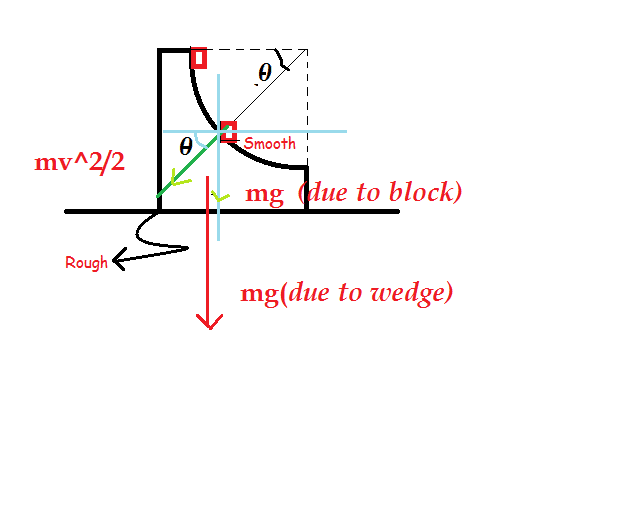

By conservation of energy
##mgr=mgr(1-sin\theta )+\frac { m{ v }^{ 2 } }{ 2 } ##
So ##{ v }^{ 2 }=2grsin\theta ##
Horizontal force on the wedge(Fx) is ##\frac { m{ v }^{ 2 } }{ r } cos\theta ##So ##Fx=\frac { m }{ r } 2grsin\theta cos\theta ##
##Fx=mgsin2\theta##
For Fx to be maximum ##d(Fx)/d\theta=0##
so
##mg\frac { d }{ d\theta } sin2\theta =0##
##\theta ##=45
So ##{ v }^{ 2 }=\sqrt { 2 } \ gr ##
Normal force on the wedge = ##mg+mg+\frac { m{ v }^{ 2 } }{ 2 } sin\theta ##=3mg
Horizontal force on wedge= ##mgsin2\theta##=mg
As wedge should remain at rest so
## 3\mu mg=mg##
So ## \mu =1/3##
But this is not correct.Where did I go wrong?

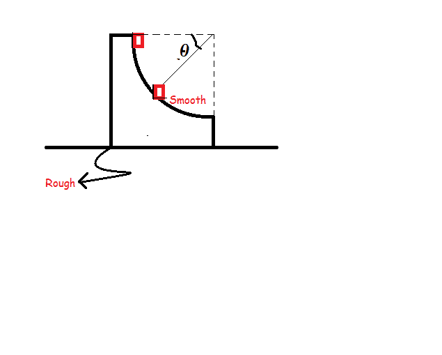

Are you sure? The force of friction depends on the normal force between the ground and the wedge, and it is not equal to the weight of the wedge.

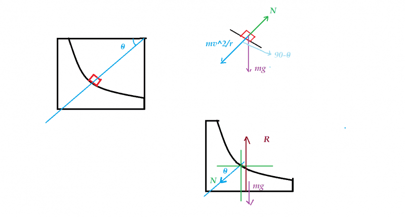

From figure 2
##N=\frac { m{ v }^{ 2 } }{ R } +mgcos(90-\theta )##
or ##N=\frac { m{ v }^{ 2 } }{ R } +mgsin\theta ##
Horizontal force in wedge ##Fx=Ncos\theta =\left( \frac { m{ v }^{ 2 } }{ R } +mgsin\theta \right) cos\theta ##
From figure 3
##R=mg+Nsin\theta ##
##R=mg+\left( \frac { m{ v }^{ 2 } }{ R } +mgsin\theta \right) sin\theta ##
Are these equations correct?
Is my expression of v2 in #post1 correct?

And you got already that ##v^2=2gR\sin(\theta)##, so N= ??

Certainly not, R is the radius, a length, it can not be force ...
Horizontal force in wedge ##Fx=Ncos\theta =\left( \frac { m{ v }^{ 2 } }{ R } +mgsin\theta \right) cos\theta ##Certainly not, R is the radius, a length, it can not be force ...
##N=\frac { m2gR\sin (\theta ) }{ R } +mgsin\theta =3 mg\sin (\theta )##
## Fx=3 mg\sin (\theta )cos\theta ##...(1)
The 'R' in the RHS is not radius.It is reactionary force on wedge.Sorry I should have choose other variable for it, let it be A.
So
##A=mg+Nsin\theta ##
##A=mg+\left( \frac { m{ v }^{ 2 } }{ R } +mgsin\theta \right) sin\theta ##
Please consider reactionary force on wedge in figure(3) in #post 3 be A.
On differentiating eq(1) wrt to ##\theta## and equating it to 0 I got ##\theta=45## maximum value of ##Fx=3mg/2##
You need maximum coefficient of friction, not the maximum horizontal force. The force of friction also depends on the normal force and on theta.
And substitute for v2 also in the expression of A.

##A=mg+3mg{ sin }^{ 2 }\theta ##
I thought by equating ## \mu A=Fx## I can solve for ##\mu##?
Solve for mu and find the smallest value.
