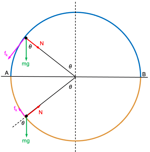

Shown on the right are two FBDs for the two paths.
From the top FBD,
##N+mg\cos\theta=m\omega^2 R\implies N=m\omega^2 R-mg\cos\theta##
From the bottom FBD,
##N-mg\cos\theta=m\omega^2 R\implies N=m\omega^2 R+mg\cos\theta##
We combine the two into a single equation and write
##N=m\omega^2 R\mp mg\cos\theta.##
The force of friction for the two cases is
##f_k=\mu N=\mu m(\omega^2 R\mp g\cos\theta).##
The top/bottom sign corresponds to the top/bottom FBD. Before writing the tangential acceleration, we note that, in each case, ##~-\frac{\pi}{2}\leq \theta \leq \frac{\pi}{2}## Since the particle starts at A and ends at B in each case, ##\sin\theta## is negative in quadrants II (top FBD) and quadrant III (bottom FBD). The positive direction in each case is the direction of the linear velocity. Thus, the linear acceleration is
Top FBD:##~a_{\text{top}}=-\dfrac{f_k}{m}+g\sin\theta##
Bottom FBD:##~a_{\text{bot}}=-\dfrac{f_k}{m}-g\sin\theta##

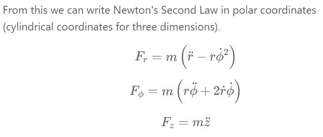

This page shows the derivation for the formulas. It's unfortunate it uses ##\phi## instead of ##\theta## and also it's got some missing equations due to formatting errors but the main idea is still there.
I don't disagree with this page and there is no misfortune to using ##\phi## instead of ##\theta##. You can see how these more general forms become what I have if you set ##\phi=\theta##, ##\dot \phi=\omega## and ##r=R=\rm{constant}##:
##F_r=-m\omega^2R##
##F_{\theta}=mR\dfrac{d\omega}{dt}.##

Angle ##\theta## is shown in the drawing of the two FBDs.
For the top diagram, ##\theta## increases clockwise as the mass moves from point A to point B. At A ##\theta =-\frac{\pi}{2}## and at B ##\theta =+\frac{\pi}{2}.##
For the bottom diagram, ##\theta## increases counterclockwise as the mass moves from point A to point B. At A ##\theta =-\frac{\pi}{2}## and at B ##\theta =+\frac{\pi}{2}.##

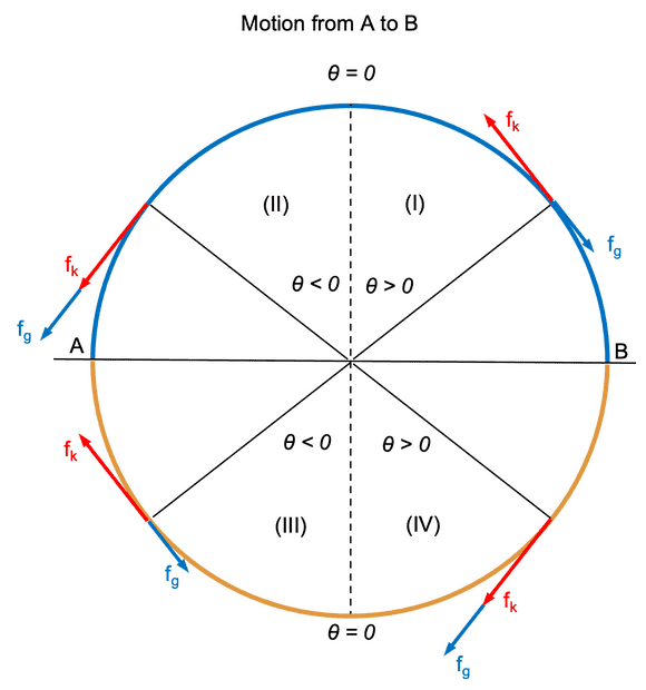

I think you're right. Let me redo it in more detail justifying the signs for the benefit of anyone who visits this thread.
See figure on the right. The motion is from A to B, clockwise for the top track and counterclockwise for the bottom track. In both cases angle ##theta## varies from ##-\frac{1}{2}\pi## to ##\frac{1}{2}\pi.## Thus, ##\sin\!\theta## is negative in quadrants (II) and (III) and positive in quadrants (I) and (IV). The positive tangential direction is in the direction of the motion, so ##f_k## must be negative in all quadrants. Writing the 1d tangential vector as $$f_k=-\mu N=-\mu m(\omega^2 R\mp g\cos\!\theta)$$ does the job as friction always opposes the motion. Of course, if ##f_k## changes sign for some angle (top track), this means that the normal force has gone through zero at which point the block will fall off.
If we write the component of gravity as ##mg\sin\!\theta##, we must be careful to ensure that its sign is positive when the mass is moving downhill and gravity aids the motion and negative when the mass is moving uphill and gravity opposes the motion. So
Quadrant (I): ##~f_g=mg\sin\!\theta.## Motion downhill, ##\sin\!\theta>0##, overall sign positive.
Quadrant (II): ##~f_g=mg\sin\!\theta.## Motion uphill, ##\sin\!\theta<0##, overall sign negative.
Quadrant (III): ##~f_g=-mg\sin\!\theta.## Motion downhill, ##\sin\!\theta<0##, overall sign positive.
Quadrant (IV): ##~f_g=-mg\sin\!\theta.## Motion uphill, ##\sin\!\theta>0##, overall sign negative.
For the two tracks the total tangential accelerations are $$\begin{align}
& a_{\text{top}}=-\mu (\omega^2 R- g\cos\!\theta)+g\sin\!\theta=-\mu \omega^2 R+g(\sin\!\theta+\mu \cos\!\theta)
\nonumber \\
& a_{\text{bot}}=-\mu (\omega^2 R+ g\cos\!\theta)-g\sin\!\theta=-\mu \omega^2 R-g(\sin\!\theta+\mu \cos\!\theta)
\nonumber \end{align}$$ Putting the two together gives the expression in post #1, $$a_{\text{t}}=-\mu \omega^2 R \pm g(\sin\!\theta+\mu \cos\!\theta).$$ The relative sign in the parentheses should be ##+## instead of ##-##. I appreciate you spotting this. One good turn deserves another. At some point I will have to repost the solved problem. Ugh!
