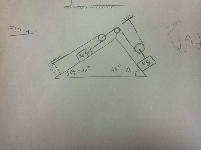

Look at figure 4
Two blocks are attached to mass-less ropes and pulleys that have negligible mass and negligible friction.
a. Find the connection between the tensions in the ropes.
b. Find the connection between the accelerations of the blocks.
c. Calculate acceleration of each block.
d. Calculate tension in each rope.

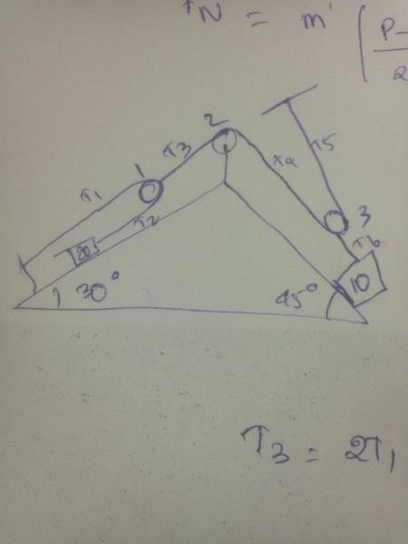

F= ma
I did FBD for pulleys and the masses.
For part a I got,
So here I said that T3=T4=T5.
T3=2(T2) (because T3= 2(T1) and T1=T2)
2(T3)=T6
For part b,
The FBD for m= 20 kg gave me,
T2-W1sin30= m1a1 in the x-direction
and the FBD for m=10 gave me
W2sin45-T6=m2a2 in the x-direction.
My teacher told me something about finding the connection between the accelerations of the masses. He said that the if a pulley accelerates over a certain distance x then the other moves over the distance L-x where L is length of the rope. Something alone these lines and for one problem we did in class he found connection between accelerations like accofblock1=2accofblock2. Something like that. I wanted to know this. I know that if I know how to find this, I can go about the rest of the two parts pretty well. Any idea?
The basic idea is this: you move one block by a distance[itex]x[/itex] in your favorite direction, you calculate how the other block _must_ move in order to keep the ropes taut, say it moves [itex]y[/itex]. Once you have a relation between [itex]x[/itex] and [itex]y[/itex], you can relate their acceleration quite easily.
Please explain a little more further. It's still not clear to me.
If I move the block with m=10 kg a distance of x meters DOWNWARD, then the 20 kg will move x meters upwards as well, is that what you're trying to say here? So acceleration of 10 kg= twice the acceleration of 20 kg? I mean how does the acceleration relate. I'm confused.
Also can you check and tell me if the I've done part a correctly?

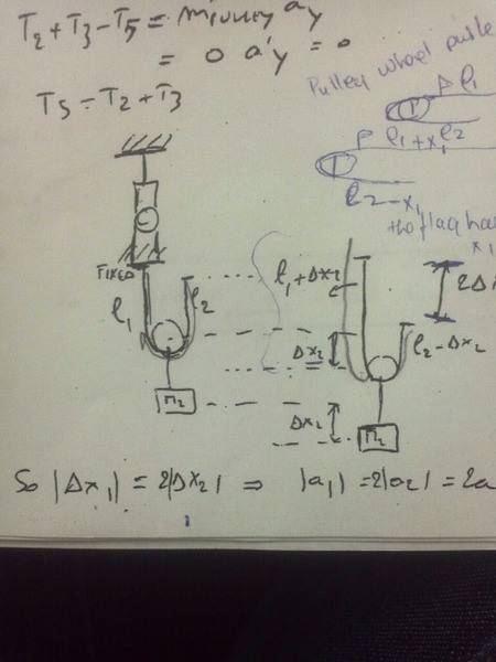

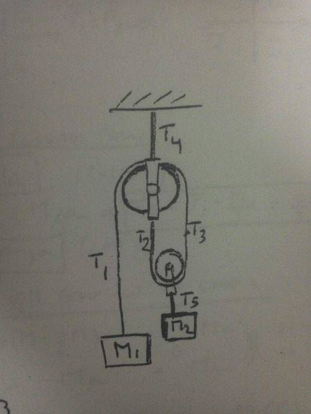

The reason why I am asking is because of this explanation my professor gave me. He showed the connection between the accelerations of the two blocks like this and I didn't understand how.
This is the actual figure to the explanation above. It's different from this problem I posted here.
He has shown that the movement from one is X and the other one moves 2X. I am not sure how. and if I apply the same concept to what you're saying then I am getting confused,.
Your confusion is justified. I was not doing the calculation correctly.
But the idea is right. Your professor has explained it mathematically already, my earlier post (below) explained it in English. I will try to explain it more clearly later tonight (unless you figure out that 4[itex]a_{10}[/itex] = [itex]a_{20}[/itex] :wink:).
