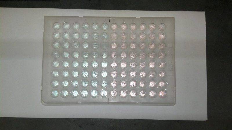

In case you are interested, here's a photo from my lab work of a plate containing solutions of Cy5 dye (left) and Cy3 dye (right). You can see look up the absorption and emission spectra of the dyes here: http://web.stanford.edu/group/bioconfocal/dyes.html#oragnegreen
Cy5 absorbs in the orange-red range, fluoresces in the red-near IR range, and appears blue. Cy3 absorbs green, emits orange, and appears red.
