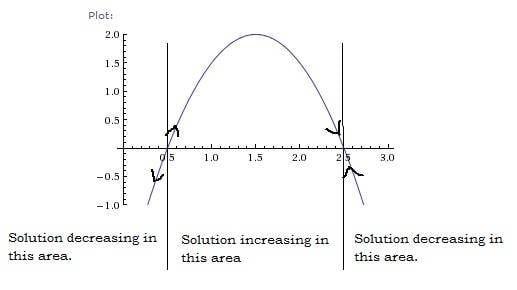

Now, If we go back to:
\(\displaystyle kP\left(1-\frac{P}{N} \right)-H=0\)
We see that we have a parabolic function, opening downward. This tells us the slope of the solution is negative below the smaller root, positive in between the two roots, and negative above the larger root.
So, what we may conclude from this is that for any initial value $P(0)$ of the fish population that is less than the smaller equilibrium point the population will decrease, approaching zero as time passes, and the fish will become extinct. If the initial population is equal to the smaller equilibrium point, then the population will remain unchanged over time. And for any initial population greater than the smaller equilibrium point all solutions will approach the larger equilibrium point. Look at the following diagram:
Ignore the actual numbers on the axes, and just look at the behavior we find for the solution to the IVP. We find that if the initial population is equal to the two equilibrium points then the population remains at those values. Otherwise, below the smaller equilibrium point, the population decreases to zero and above the smaller equilibrium point, all solutions converge to the larger equilibrium point. Thus, we may conclude that if:
\(\displaystyle P(0)>\frac{kN-\sqrt{kN(kN-4H)}}{2k}\)
then:
\(\displaystyle \lim_{t\to\infty}P(t)=\frac{kN+\sqrt{kN(kN-4H)}}{2k}\)
