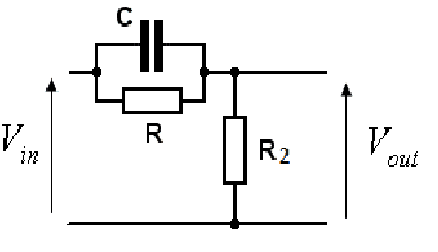

In summary, the homework statement is that a student has to approximate the frequency response by using bode plots. The student became stuck on plotting the bode plot and is unsure if their transfer function is correct. They recommend reading a pdf on the basics of bode plots before continuing. The student also noticed that the plots did not compare to their real-life results and that there are errors in the calculations. The student found the static gain and zero to be wrong in the plots. The student recalculated the values of the transfer function and found that the amplitude plot should remain constant until the frequency of the zero. After that, it should start rising and then remain constant after that. The student also noticed that the phaseplot starts
Mitchy190
42
I have the transfer function:
for the circuit:
The component values are know, and are:
R1 = 47kΩ
R2 = 4K7Ω
C = 10nF
I have derivied the transfer function but have become stuck on plotting the bode plot.
I understand that the function has one pole at
[itex]\frac{-1}{R_{1}C}[/itex]
And one zero at
[itex]\frac{-1}{R_{3}C}[/itex]
But I am unsure on the next step, and some advice would help. Thanks (:

I am now unsure that my transfer function is actually right, I have plotted a bode for the magnitude and it does not compare to my real life results at all, which i am assuming are right.
I worked out the bode plot by
[itex]|H(Jω)| = 20Log(|A|) + 20Log(|1 + jωRC|) - 20Log(|1 + jωR_{3}C|)[/itex]
And I got these results
The real measured results I obtained are:
As you can see they look completely different? Is my transfer function wrong, or is it the method in which I have plotted the bode?
Thanks.
It gave me the same transfer function you got with the only difference that [itex]A=\frac{R_{2}}{R+R_{2}}[/itex]. However as [itex]R=R_{2}=47[kΩ][/itex] this doesn't make any difference. So it seems to me that according to the data and circuit you gave that the transfer function is right
Regarding to the plots you posted i noticed the following:
-the static gain A is equal to 0.5 what implies that [itex]20log(|A|)\approx -6.02 [/itex].However in the calculation you made it gave -20.8. It seems to me that is a wrong value.
-In the first post you made the frequency of the poles were in rad/sec, but in the plots the frequency is in Hertz.
-the zero is at the frequency [itex]\frac{1}{RC}\approx 2127 [rad/sec] \approx 338[Hz][/itex] and the pole at the frequency [itex]\frac{1}{R_{3}C}\approx 4255 [rad/sec] \approx 677[Hz][/itex]. Using the asymptotic approximation the amplitude plot should remain constant with a value of [itex]20log(|A|)[/itex]until the frequency of the zero. Then due to the zero it should start rising at 20 dB/dec until the frequency of the pole, remaining constant after that(because the pole adds -20dB/dec). When [itex]w\rightarrow \infty \Rightarrow 20log(|H(jw)|)\rightarrow 0[/itex], so the amplitude plot you measured seems to give what was predicted theoretically except in the fact that the static gain is of -12 instead of -6.
-after making the table for the numerator and the denominator of the transfer function as you did, it gave me different results. Try to recalculate the values to see if you get the correct amplitude plot.
-in the phase plot, it should begin by rising because the zero appears first than the pole, and then start falling one decade before the frequency of the pole. However in the phase plot you measured it starts by falling first. According to the circuit and the component values you gave this should not happen.
Note: Just to be sure by 4K7Ω you mean 47000 [Ω] right?

[itex]\frac{R_{2}}{R + R_{2}}[/itex] = [itex]\frac{4700Ω}{4700Ω + 47000Ω} = \frac{1}{11}[/itex]
[itex]\textit{-20log(A) = -20.828}[/itex]Im still unsure where I have gone wrong, I just know I have, I think. I think the one where the frequency and phase response are given is right, but i didn't approximate that (which i need to do).

Yup the error in the static gain was the resistance R2. Now the amplitude plot is equal to the one you measured. However the calculations you made in that table for the numerator and the denominator of the transfer function, are still giving me different results. Did you used w=1,10,..[rad/sec] or f=1,10,... [Hz]?
So you are getting the same result as me now? As in you are getting the shape of the black line for the overall magnitude response?
Everything is in hertz on both graphs, so I varied ω (f) over 10hz --> 1000000hz to get my results.. I get the same shape graph in radian/second anyway.
Nope I am getting the blue one, in the real measure. I am seeing your other post at the same time too and the last plot you posted its what is giving to me. How are you calculating |1+jwRC| ?
to get the equation above I did the below:
Start with:
H(jω) = R2/(R2+(R*1/jωC)/(R+1/jωC)) (note that R1 is only named R in the picture)
pick the term (R*1/jωC)/(R+1/jωC) multiply nom. and denom. by jωC to get
(R*1/jωC)/(R+1/jωC) = R/(1+jωRC)
You now have H(jω) = R2/(R2+(R/(1+jωRC))
multiply nom. and denom. by (1+jωRC) and you'll get
H(jω) = (R2*(1+jωRC))/(R2*(1+jωRC)+R)
multiply the parentheses in the denom into the long form and you'll get
H(jω) = (R2+jωRR2C))/((R+R2)+jωRR2C)
now divide nom. and denom. by (R+R2) and get
H(jω) = (R2/(R+R2) * (1+jωRC)) / (1+(R2/(R+R2))*jωRC)
simplify by substituting (R2/(R+R2) = A, R3 = (RR2/(R+R2) to get
H(jω) = A *(1+jωRC) / (1+ jωCR3)
No I was asking if you are calculating 20log(|1+jwRC|) as 20log(sqrt(1+(wRC)^2))?
Oh sorry, yes I am.
20*LOG10(SQRT(1+w/2127.659))
2127.659 = 1/RC
Oh but is not 20*LOG10(SQRT(1+w/2127.659)) its 20*LOG10(SQRT(1+(w*47E3*10E-9)^2).
That may be where I'm wrong!
I thought it was 20*LOG10(SQRT(1+w/2127.659))
As I thought when the imaginary part is equal to the real you get the break frequencies, and the frequency at that point is w = 1/RC ?
Anyway, made the correction?

Yup, thinking that way, when the real part is equal to the imaginary you have either a pole or a zero.
I think you posted here the wrong attachment cause that one is the initial one...
I saw what you posted in the other thread and it is what i have.
Then I do not understand why the below is not correct
2127.659 = 1/RC
My bad,
View attachment 20logg.pdf
The only mistake you made in 20*LOG10(SQRT(1+w/2127.659)) is that you not squared the imaginary part. I wrote 20*LOG10(SQRT(1+(w*47E3*10E-9)^2) which is equal to 20*LOG10(SQRT(1+(w/2127.659)^2). I used the multiplication because 2127.659 is an approximated value and 47E3*10E-9 is the exact value.
Note: |a+jb|=sqrt(a^2+b^2)
Ahh i see! Thanks for you help dude.

I saw your table and you made a mistake in the calculation of the argument. Given a complex number the argument is given by:
arg(a+jb)=arctan(b/a)
and given two complex numbers z1,z2 you have the following properties:
arg(z1*z2)=arg(z1)+arg(z2)
arg(z1/z2)=arg(z1)-arg(z2)
so applying this to the transfer function you get:
arg(H(jw))=arg(A)+arg(1+jwRC)-arg(1+jwR_3C)=0+arctan(wRC)-arctan(wR_3C)
In your table you should have then:
tan^-1(wRC) || -tan^-1(wR_3C)
Note:arctan and tan^-1 its the same

Ahh yes! Thank you, I have corrected that (:
The formula in my table, for the actual column is =-arctan((ω/23404.235))
where,
23404.255 = 1/R_3*C
Also I was just wondering, on my friends graph the phase starts to shift at 10 hertz and on my graph it starts to at 100 hertz?
Do you know which one is correct?
The formulas below show how I am working out mine:
ATAN(((w*R*C)))
-ATAN(w*4700*R3*C)
then,
ATAN(w*R*C) - ATAN(w*4700*R3*C) = arg(H(jw))
