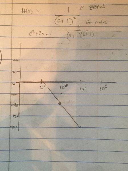

Hi,
I just need some confirmation on 3 questions
H(s) = 1/(s+1)^2
1. I was asked to calculate the poles and zeros. I believe
zeros: none
poles: 2 (or p1,2) = -1
2. I was also asked to calculate the slope of the magnitude response was w -> 0
Here is my sketched graph
From my pic, it shows that as w -> 0, H(s) -> 0.3. What type of filter response does this network exhibit.
I believe it will be a Low Pass because as
s->0, H(s) -> 1 and as s-> infinity, H(s) -> 0?
Does this reasoning make it a low pass filter, high pass, band stop or band pass?
Any help is appreciated
According to your graph, what frequencies pass thru with the least attenuation?
Your Bode plot is good, and I can only second TomG's rhetorical question.
