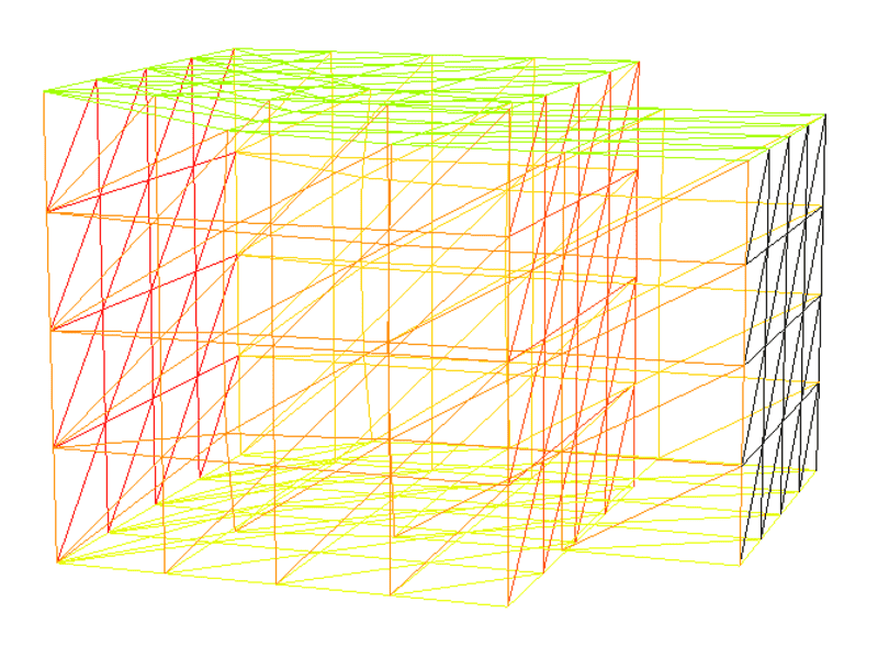

I have an issue with understanding the body forces in the context of FEM simulations. I am using freefem to do the simulations.
So I took a simple unit cube, fixed the displacements at side ##x=0## and prescribed a displacement ##u_x = 0.025## at ##x=1##. If required, the entire script is given below.
Cube example:

Now the results look completely fine to me:
However, the problem.

I think the conclusion is that your medium is not in static equilibrium.
You are essentially pulling the medium along the [itex]x[/itex]-axis in order to achieve the displacement. If you want the result to be in static equilibrium, you need to apply an external force to resist the medium's desire to return to its equilibrium ([itex]u \equiv 0[/itex]) state.
I'm also not convinced that your definition of [itex]\sigma[/itex] is consistent with your definition of [itex]\epsilon[/itex]. Generally in a linear theory you would have [tex]
\epsilon_{ij} = \frac12 \left( \frac{\partial u_i}{\partial x_j} +\frac{\partial u_j}{\partial x_i}\right)[/tex] and [tex]
\sigma_{ij} = 2\mu \epsilon_{ij} + \lambda \epsilon_{kk} \delta_{ij}.[/tex]
Yes, you are correct, my definition of ##\sigma## is a wrong by factor 2 on all off-diagonal terms.
