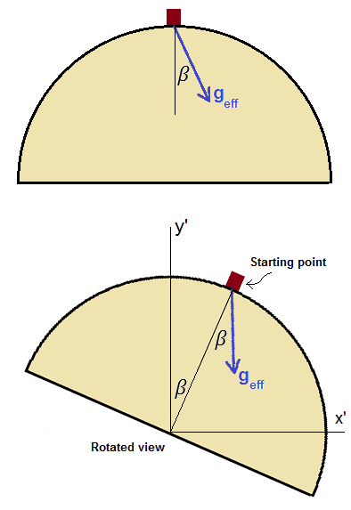

It might help to have a diagram. Let's suppose the hemisphere accelerates to the left relative to the Earth so that the body slides down the right side of the hemisphere. In the frame of reference of the hemisphere you replace ##\vec{g}## by ##\vec{g}_{\rm eff}## which is directed at some angle β as shown in the top diagram.
I found it helpful to rotate the top diagram to have a diagram in which ##\vec{g}_{\rm eff}## is vertical.

So you say to consider the rotated form and to solve the problem just like when the hemisphere is motionless and to use instead of mg, mgeff?If so,how do we know the angle the body leaves the hemisphere isn't included in the initial angle we rotated the system;I mean how do we know the body after the "rotation" is still on the hemisphere and leaves it some time later?Won't we have to consider some constraints in that way (which I have to admit it helps)?
In the rotated diagram, the body starts from rest at θ = β. As long as β < 90o, the body will have to slide a finite distance along the spherical surface before it falls off.
What if,for instance,β=10 degrees and the body normally falls off at 5?
Suppose in the lower diagram β = 10o. Then the block would have to fall off at an angle θ > β in the lower diagram, say θ = 15o. What would this mean in terms of the angle θ that the block falls off in the upper diagram?
That normally falls off at 5 degrees and there is no problem.But what if it would have fallen off for θ<β?Anyway,if we don't rotate it,then the y-component of geff (perpendicular to the ground)would be g,so in the equation of the energy conservation we would have mgeffyh=mgh.Or not?
In the lower diagram, β is the value of θ at which the body starts at rest. It won't fall off until it has traveled at least some distance. So, the body must move through some angle Δθ before falling off. That means that the body must travel through the same change in angle Δθ in the upper diagram before falling off.
The magnitude of the change in potential energy due to geff is mgeffd where d is the distance the body moves parallel to ##\vec{g}_{\rm eff}##. In the lower diagram, d is just |Δy'|.

I probably should use a prime on θ to denote the angle from the y' axis in the rotated figure. So, in the rotated figure, the body starts at θ' = β, which corresponds to θ = 0 in the top figure. In the rotated figure, the body falls off for some θ' > β, which means it falls off for some θ > 0 in the upper figure.

Draw a figure showing the initial position and final position of the block (where it leaves the surface). Draw a vector between these two positions. This is the displacement vector Δr of the body. d is the component of Δr in the direction of geff.

I think I found an equation for the relative velocity,considering the rotated system as you advised me to.I have:
urelative=[itex]\sqrt{}2R(g-gcosθ+Wsinθ)[/itex]. It yields Urelative=0 for θ=0.
  • #35
urelative=[itex]\sqrt{}2(g-gcosθ+Wsinθ)[/itex]. It yields Urelative=0 for θ=0.
Except for a missing R that looks good!
