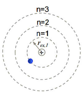

An exciton is a bound electron-hole pair (in a semiconductor). For this problem, think of an exciton as a hydrogen-like atom, with a negatively charged electron and positively charged hole orbiting each other.
The permittivity of free space (ε0) is replaced with permittivity of the semiconductor (ε = 12).
The mass of the electron is replaced with the effective mass of the electron-hole pair.

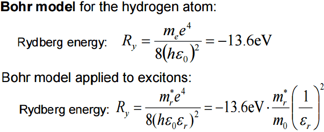

A)
12*a0/0.15 = 4.2nm (n2/z)
Ry = -13.6eV

adamaero said:
Ry = -13.6eV
You get the same Rydberg constant as for hydrogen?

Oh yes, sorry, with ε:
The energy (for part A) is mee4/[8(h*1.0359*10-10)2]
= (9.1*10^-31)(e^4)/[8*((6.626*10^-34)*(1.0359*10^-10))^2]
= 1.32*1057
Was that suppose to be a different mass?

The binding energy of an electron to the nucleus in the hydrogen atom is 13.6 eV.
So the binding energy is the absolute value of Rydberg energy??

sol.
A) The 4.2nm (n2/z) is correct. The energy is found this way: E = m*e4/(8h2ε2), but
B) 0.235 nm or 0.543 nm means that there are multiple atoms in-between each
C) This is the same E1, but can be modified from more general E1 = me4/(8h2ε02) = -13.6 eV... E = E1*(mT/m)/[(ε/ε0)2]
