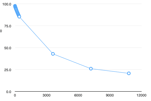

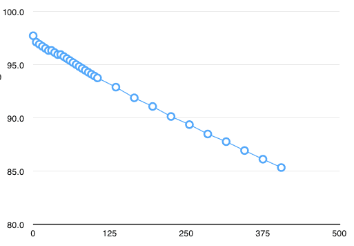

I believe this may be partially responsible for the effect. It probably takes me about 5 seconds to get the jar out and get the probe in the sample. Then probably 3 maybe 4 seconds for the thermometer reading to stabilize.
Would you expect the cooling rate to be linear? In other words, by subsequent measurements during the cool down period, could I extrapolate how far it dropped during the 7 seconds?
If you plot the temperature against time, you would expect an exponential curve. If you plot log(temperature) against time (t=0 would be the time you stopped the heating and removed the container), from the earliest you manage to grab a reading, you would expect to get a straight line. If you extrapolate backwards to the time you removed the container, your straight line would go through the temperature it started with. As with all heat measurements, there are possible errors and it would only help to reduce them. Actually, if you do a linear plot of temperature against time and you find that you can draw a fairly good straight line through the first few points, extrapolating back to t=0 could probably be good enough. Why not use both methods and see which one takes you closer to 100°C?
If this is all done with digital sensors, a decent spreadsheet could take in all the data and do all the hard work for you. And if you are not familiar with the simple coding that you can do with Excel, now could be a good time to get stuck in. Excel is pretty wonderful and has been for nearly thirty years of my experience.
That was a lot of work to write that post. Thanks for that. I know some Excel. I'll try it both ways. and post the results.
