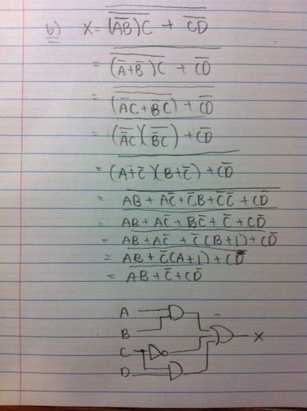

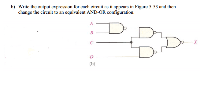

Is my solution correct or can I simplify it even further?
Is your final gate OR or NOR?
Oh, that should be a NOR. Other than that mistake is all my work correct?
I see you applied de morgan's theorem to the AB term in the beginning, why did you not opt to apply it on the NOR function?
Oh right, when I did this I didn't know you could use DeMorgan's on three terms, I just found this out today. I will simplify it further now with this new knowledge.
That should eliminate the need for so many calculations, although it is important to learn them as well.
I am not certain but I think applying de morgan's theorem to the NOR function might get you to a final solution in three steps
