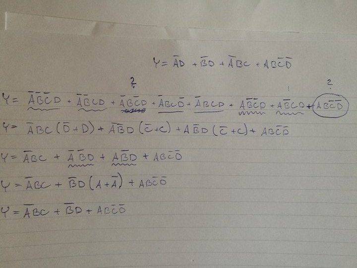

How to simplife it? I would like to see a process of simplification.
Y = A'B'C'D + A'B'CD + A'BC'D + A'BCD' + A'BCD + AB'C'D + AB'CD + ABC'D'
The ' denotes a bar over the previous letter.My second question is:
Y = BC + AB'D = (uploaded picture)
Y = A'D + B'D + A'BC + ABC'D' = ??
Simplification Rules
I tried it but can't get to the correct result.
The correct result should be (made through Karnaugh map):
Y = A'D + B'D + A'BC + ABC'D'Thank you for any advices and I'm sorry for my english.

Hi NascantOxygen,
it's A'B'D
Could you look at the image I uploaded, it's my attempt.. as you can see I can't get to the right solution.
The most obvious mistake is that you have ignored one term in the given expression, viz.,
+ A'BC'D +
In Boolean algebra you may encounter an expression such as (C + C' D) and wish to simplify it. One way is to AND the C term with something having the value TRUE, and I'll choose (1 + D) which has the value 1 because anything ORed with TRUE is TRUE.
C(1 + D) + C' D
= C.1 + CD + C'D
= C + D(C + C')
= C + D

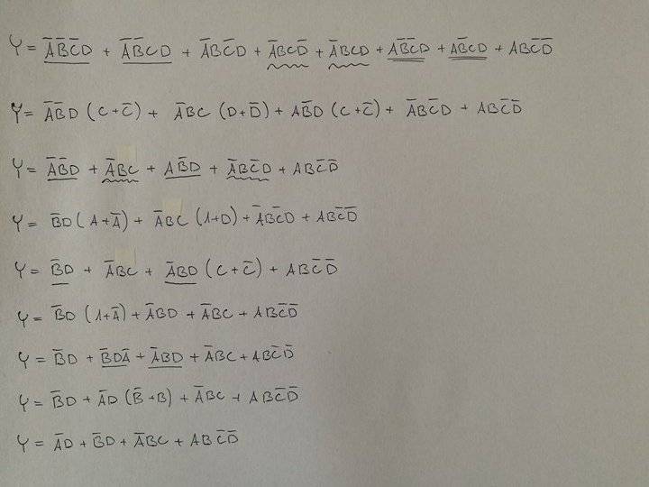

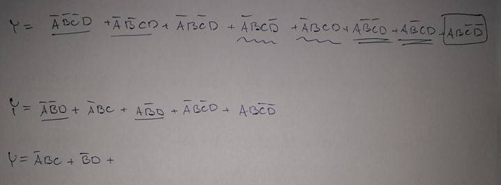

Can't get further...
Take two of these terms (shown in green) and simplify them using the help shown in post #6
A'BC + B'D + A'BC'D + ABC'D'
Is it right?
That is right.
Thank you for your time and patience with me! :) The problem is solved.
