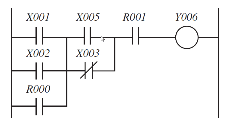

In the diagram, Y006 is a lamp, and X & R references are relay contacts. Write down a Boolean expression for the lamp to light.

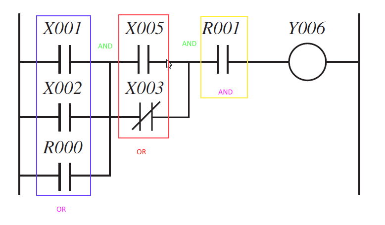

This is what I have done as an interim step to help me visualise what's going on:
This is the final answer
Is this correct?
Thanks
That is it!
