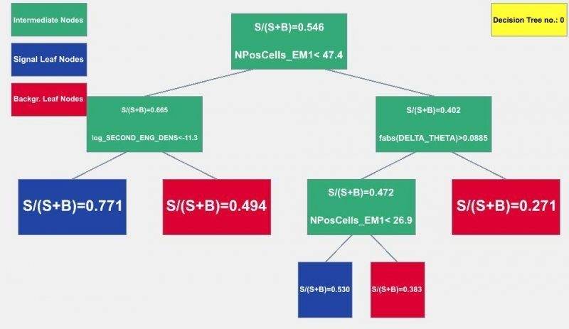

Taking a discrimination for the best discriminating variable, the algorithm will check whether some variable cut is satisfied and will lead to YES or NO.
Then to the resulting two boxes, another check is going to be done with some other variable. And so on... However I don't understand how this can stop somewhere and not keep going until all the variables are checked (I don't understand then the: "until the number of events in a certain subsample has reached a minimum number of objects").
A picture of what I am trying to explain is shown below (the weird names are just the names of the variables, S:signal, B:background):
If you just have 100 events (random number) left in a category, your statistical fluctuations are too large to draw reasonable conclusions. You would just define your cuts based on random fluctuations and the resulting S/(S+B) values would look much better than they really are.
