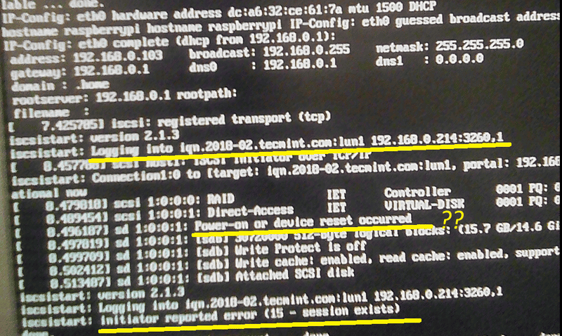

Just wondering if anyone having experience with scsi / iscsi can help out ?
I am trying to boot a set of raspberry pies from an iscsi target server I have set up on Linux Mint (Cinammon). The setup works fine for network booting via NFS so I think I have configured the tftp , dnsmasq and nfs side of things correctly. The raspberry pi is able to find it's boot directory and associated boot files (plus config files) and everything works fine if we root mount an NFS share.
For iscsi SAN boot, one just needs to change the config.txt file to supply the name of an iscsi enabled initramfs and the cmdline.txt file to indicate the iscsi initiator and target. The raspberry pi finds everything correctly but at some point in the booting process it needs to login to the iscsi target so as to access the iscsi connected block device (Lun). At this point it comes up with the following error:
iscsiadm: initiator reported error (15 - already exists)
I believe this is an old bug associated with iscsistart. If anyone happens to know of a fix or work around, please advise.

During the boot process, scsistart seems to login to the target successfully and shows the block device as sdb. Then tries to login again - I'm not sure why ?? Also not sure about the "power-on or device reset" which seems to occur. Belows is a screenshot from the raspberry pi during net boot. I'll also try checking the logs on the target server.
